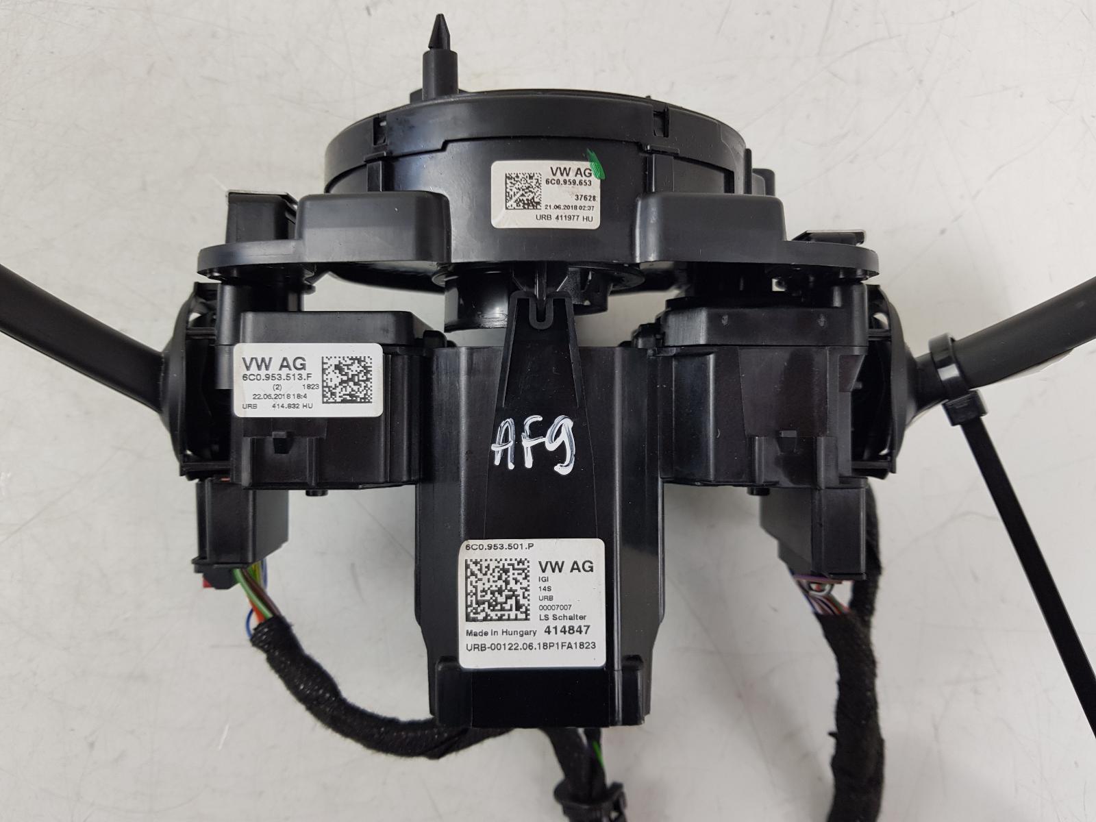

New update, Some will know ive had a reoccuring issue with a dealership and a cruise control retrofit going awfully hideously wrong.
Anyway, Before I take it to a VW Retrofitter and pay more mad bucks for an attempted fix, I'm going to try it myself.
i've ordered a new steering wheel stalk (6C0953501P IGI, or 6C0953513F, not entirely sure as it has both on it) and will be fitting it myself and it should (fingers crossed) fix the main beams issue I had.
No coding is required by me as its already coded for CC.
Once the part arrives ill be following instructions of the excellent @wirer from his brilliant blog (which you should check out, by the way https://wirer.sk/f3_tempomat/) and letting you's know how it went
Picture 12 of 12
Quick update from the past few days.
Today I enabled ESC Sports mode and ESC OFF in my car settings, this allows me to set the ESC/ASR System to Active/ESC Sport/ESC Off. Works fine.
Cruise Control was also fitted with the new stalk working grand. Dealer clearly talking ****e when they say the retrofit "isnt compatible". If anyone wants to do so themselves drop me a DM and ill try help out.
