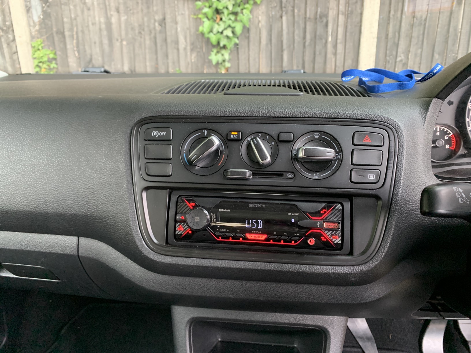

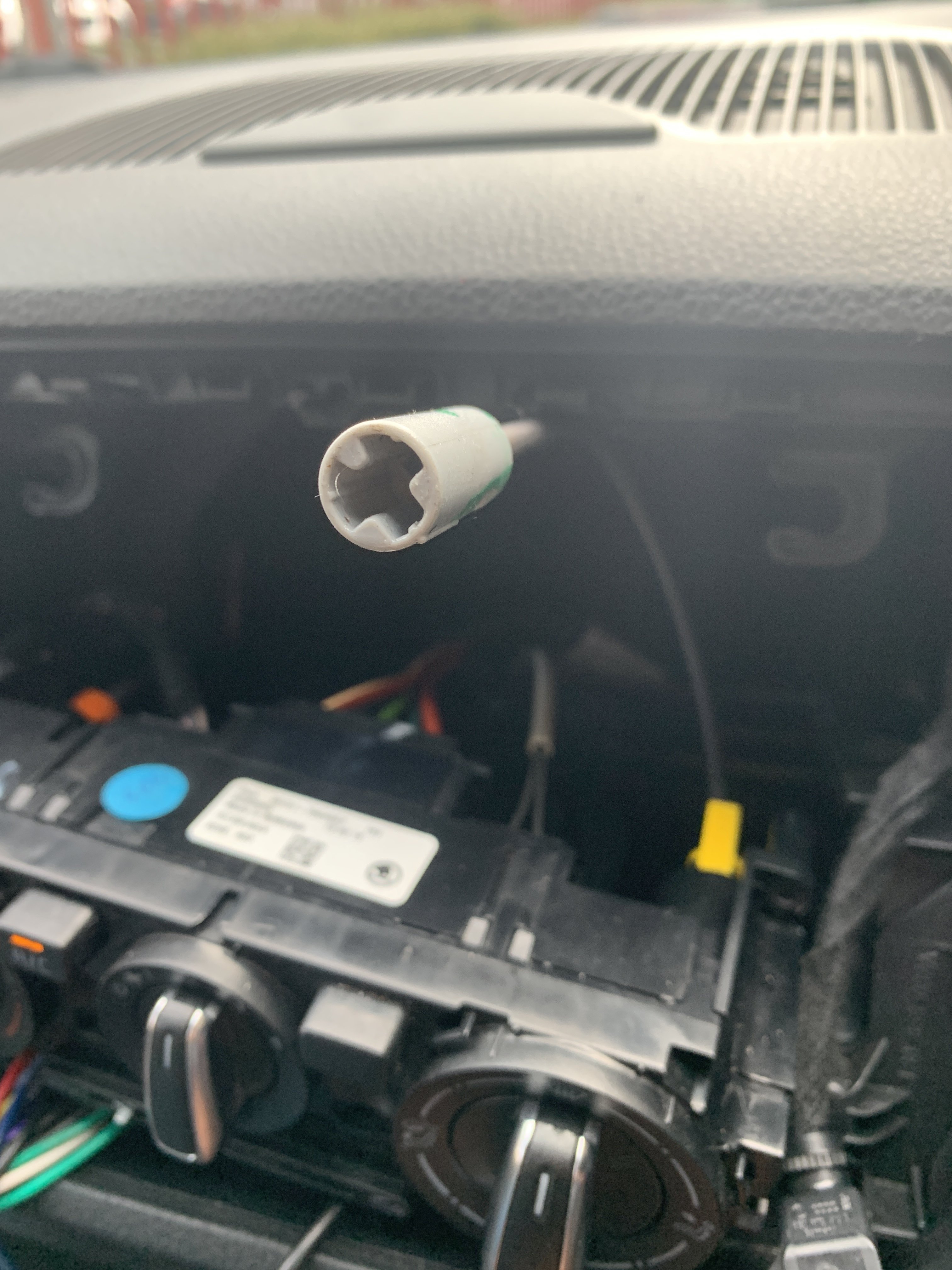

Citigo aircon direction knob is not working. Always blowing in the face
This knob on the right to redirect to wind screen and foot well is not working. Always directing air at face level.

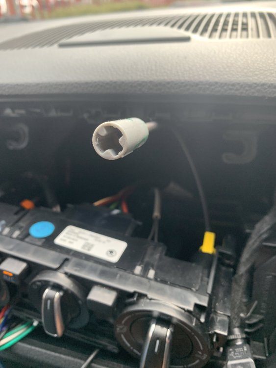

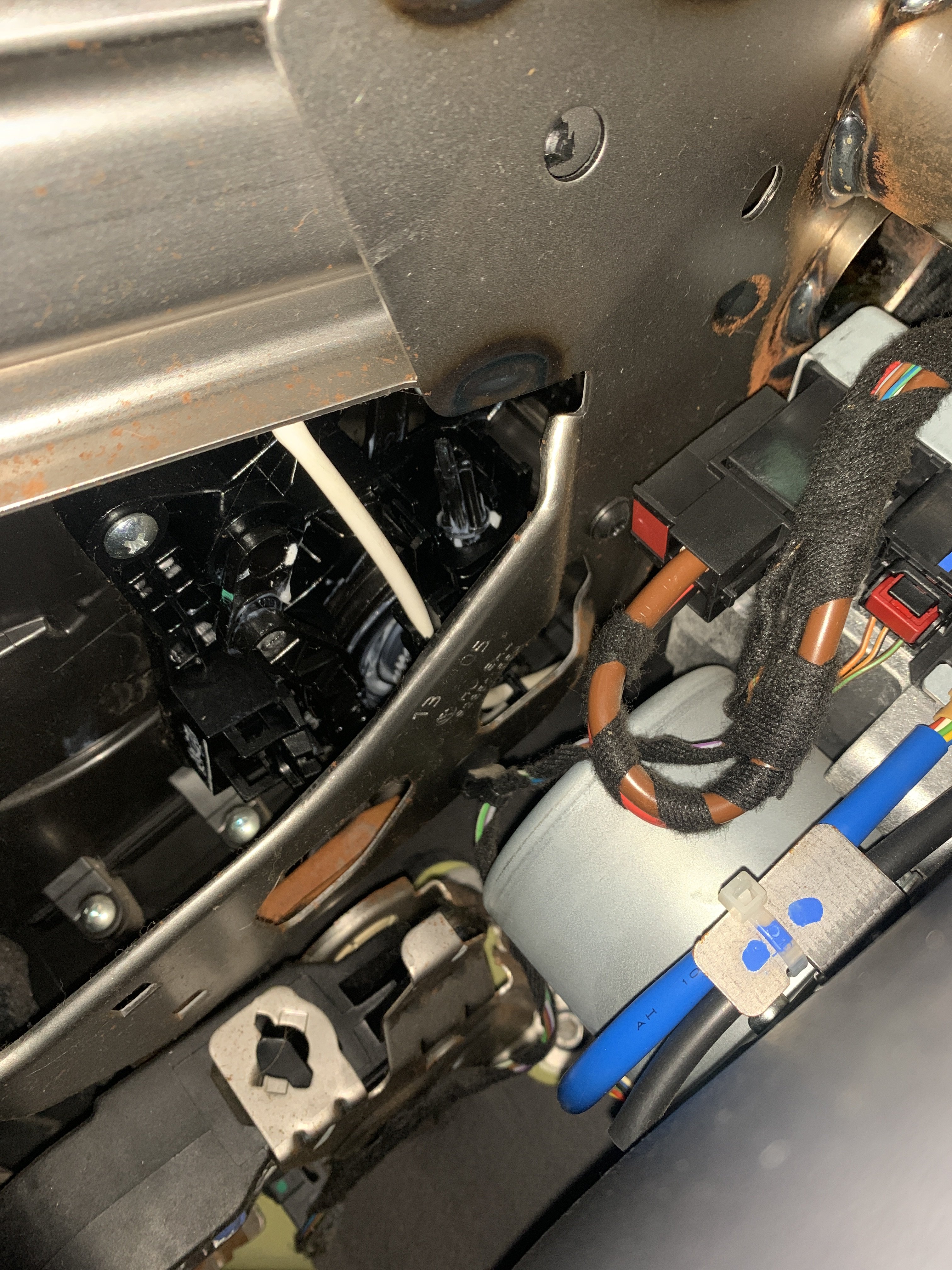

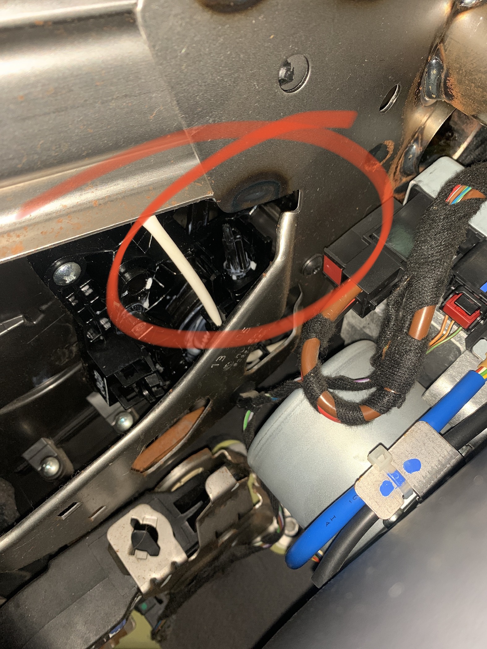

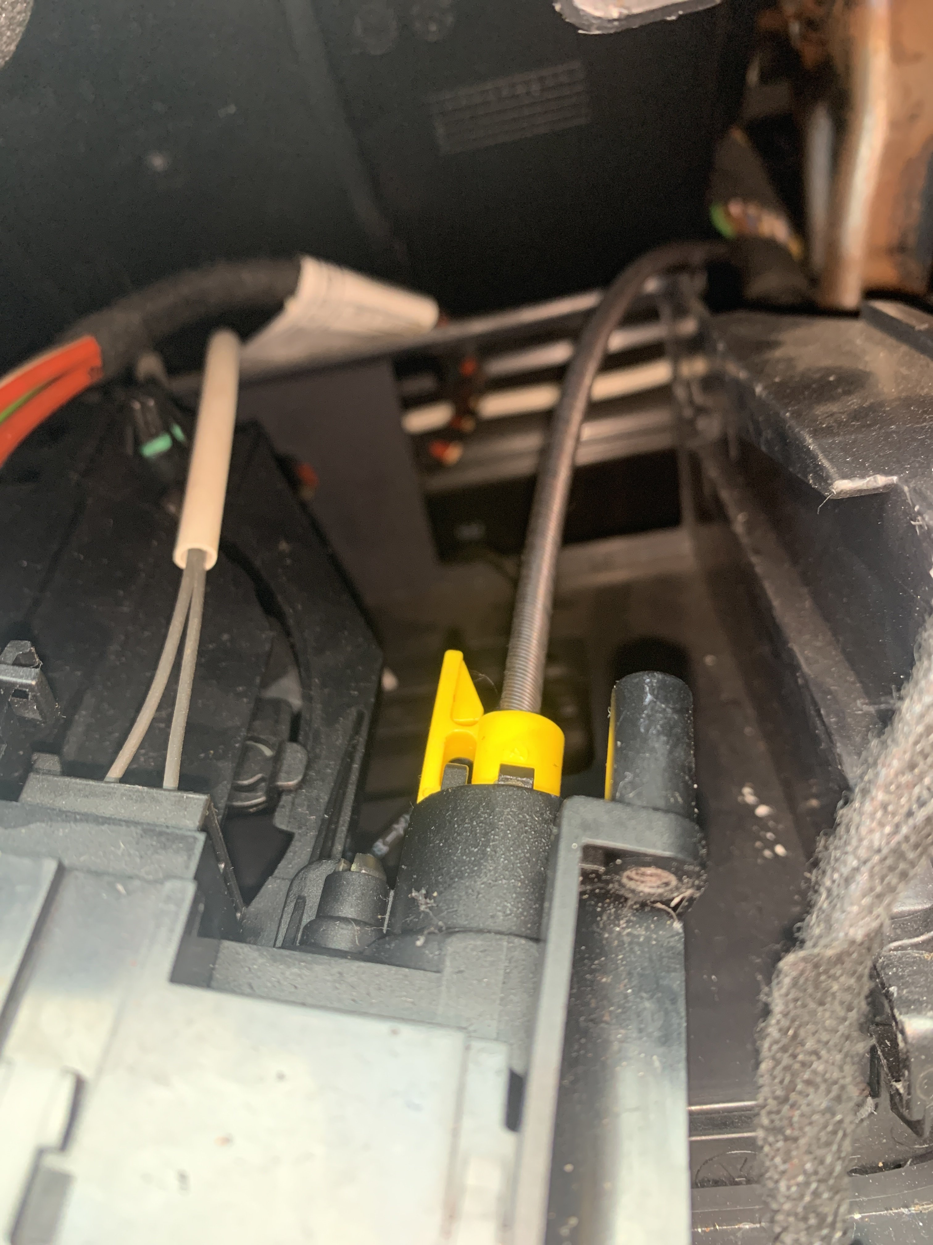

It was a pain to get to but I fixed it.
a physical rod connected from the knob to the actuator which turn the air flow up down and face.
pretty simple and manual system E6CA029A-5BDE-439B-BC05-6252E40D7E67.thumb.jpeg.09bbb9925e6f3d1c537ea7c972419c5c.jpeg, looks like to got knocked out by the previous owner trying to change the radio system.
