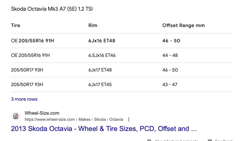

We know they're 16" wheels.  The other numbers you need are the offset (distance the rim is offset from the hub) which will start with an ET, so will look something like ET48 or similar, and the wheel width (between the rims) which will look something like 6.5J.
You'll also need the same number of studs (five I expect) and the same PCD (Pitched Circle Diameter - the size of a circle taken from the centre point of the stud holes).
Gaz
EDIT: from a quick google search:
527671420_Screenshot2023-07-25at11_34_04.thumb.jpeg.d9730397db53ce3cf485319f80d8759b.jpeg

Knowing what I'm looking at I can now see:
6.5J x 16H2ET46
I've found some Audi wheels on Facebook which match except the offset is ET50. I'm not sure if that's a problem.

50mm ET is obviously within the range that'll fit, according to Google.
