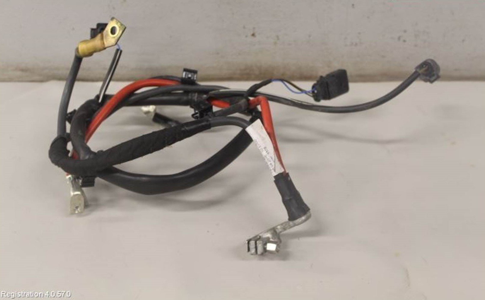

It was a main wiring loom connecting the ignition switch, alternator, battery and starter motor. Power was not getting from the battery to the allow the car to start "just a relay click" and even with a jump pack no luck. The breakdown agent as car was stuck on my drive got it started by applying a jump pack directly to the starter and it fired up and drove to the garage no problem, once parked at the garage, he said try restart it and it didn't, "just clicked". The garage replaced the loom once technician diagnosed the fault and it there has been no further problems. There was load of oil they had to clean up.
I looked at the wiring loom today. It was clean, so I suppose it will be fine.
As long as there isn't any noticeable cracks to any of the wiring looms insulation you should be ok. The damage for me meant the battery also wasn't getting a stable charge from the alternator, was charging as low as 9-11v rather then 13.5 and 14.8v peak.

My Skoda Fabia has just had its service & MOT. I have a folder with all the service history in and I have looked up the wiring loom that failed. VW part number 6C0 971 349 PC. It was the battery connections to the alternator.
