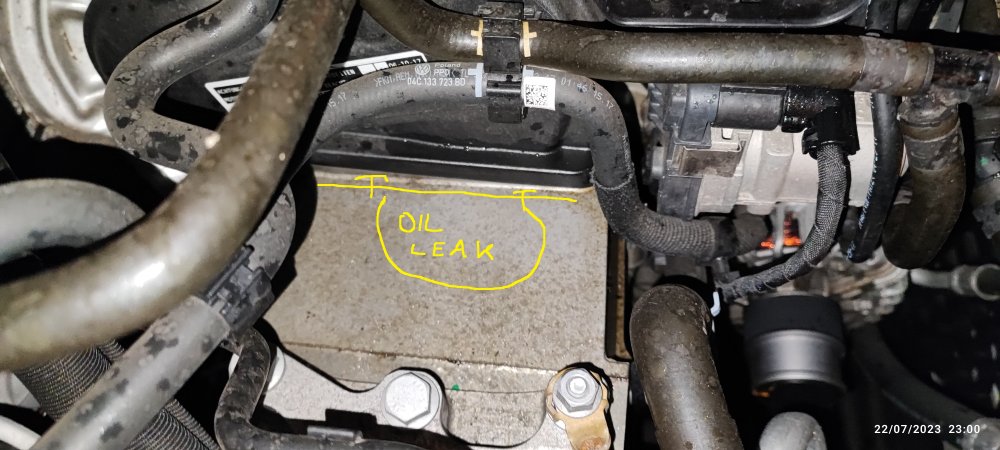

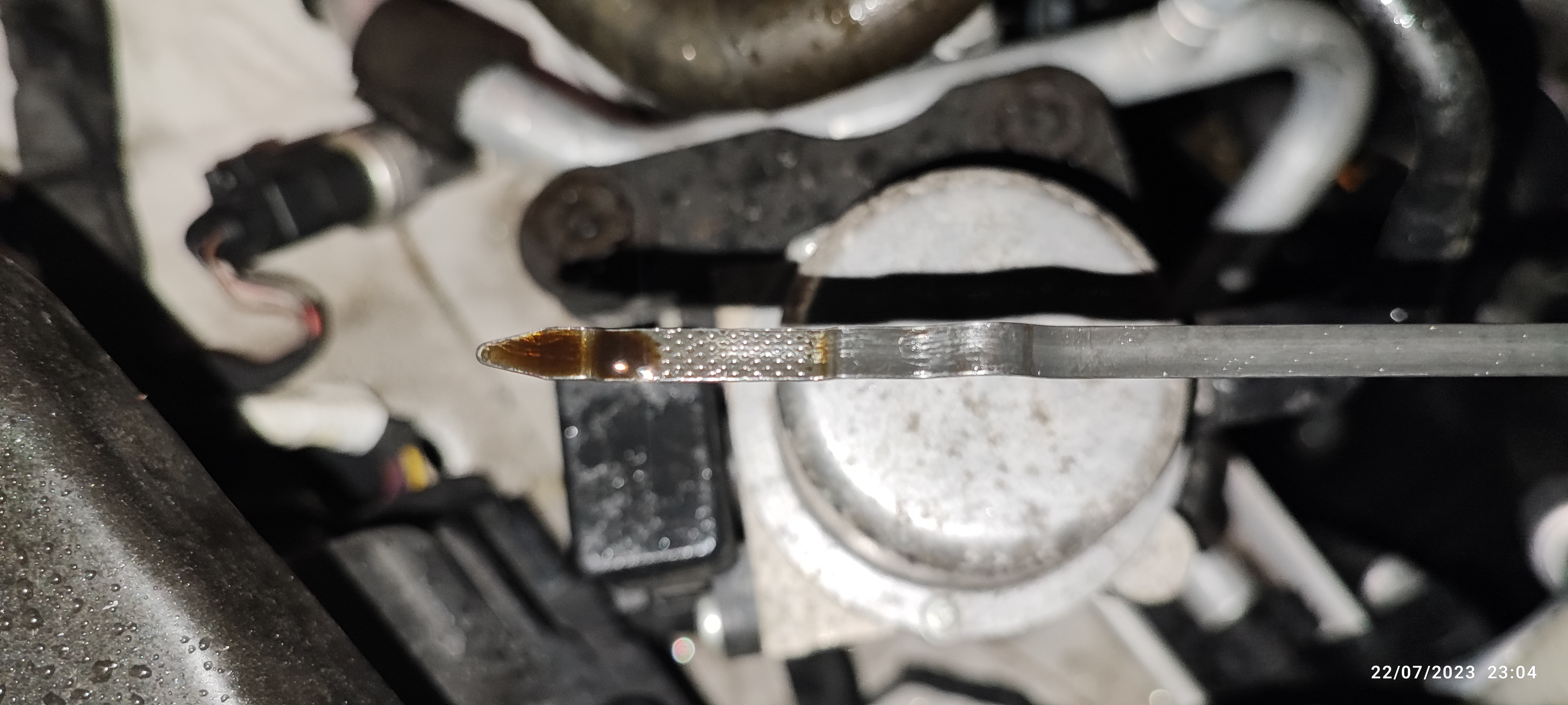

Last Saturday night, I noticed oil on my driveway (rainbow colour) also when I visited my local supermarket oil also in the car park by where I had parked, once I got home and car had cooled down, I checked engine oil level and it's low. The oil which i mopped up was leaking from the cambelt area. I've had no running issue, overheating or warning lights. I haven't driven the car this past week and it's booked in with Skoda next week.
I've come across this same problem from other Skoda owners, including VAG brands VW, Seat and Audi. Please can someone tell me what is the common cause of this leak and the most likely culprit?

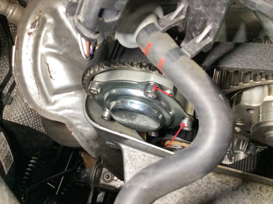

I don't want to panic you, but it sounds a lot like one of the cam shaft variable pulleys is "coming apart" due to bolts slackening off, so try hard not to use this car and get it taken to a workshop that understands these engines.
To explain more, the medium used to vary the cam shaft timing is the pressurised engine oil - and it is that that will be leaking out from between the slackened off fixing bolts - this is yet another VW Group disgrace!

Yes its a known issue and IIRC there may be an official Tech bulletin issued so in that case the repair should be free. Requires new cam phaser pulley(s) and new cambelt fitting as well as a clean up.

You were spot on about the cause of the oil leak and this is what the Skoda technician found, slack bolts. The cambelt was all intact but a whole new kit is being fitted due to oil contamination. I have extended warranty but the dealer and service department have managed to get the cambelt also thrown in for free. The dealer also said this is a known issue also on Audi, Seat & VW. I learnt too the water pump is electronic unlike my previous Renault Clio which was timing belt driven.

Thanks to this forum I managed to solve the leak myself. After removing the timing belt cover, I found one screw was halfway out, and three others could be turned with my fingers.
I checked the torque on the only bolt that seemed tight, which was at 17Nm, and torqued the other bolts to the same spec after adding thread locker. I later found out that the correct torque is 8Nm + 45deg, so I hope it will be OK anyway.
Finally I disassembled and cleaned the plastic at the bottom of the engine bay and after 100km it seems there are no leaks. It seems it lost less than 0.5l of oil, and oil level is still in the correct range.
I checked the timing belt and it seemed to be mostly clean of oil, so I think I will be able to save it. I sprayed a rubber compatible degreaser to the belt and after revving the engine, a bit of oil splashed on the cover. After everything dried up I tried it again and there were no further splashes, so I assume the belt is dry and fine.

8Nm + 45° turn may well equate to something close to 17Nm. Torque plus angle is just a more accurate means of getting a given pre-tension in a fastener.
Working out theoretical equivalence is tricky, because friction is so dominant, and unpredictable, in traditional torque-only specs.
