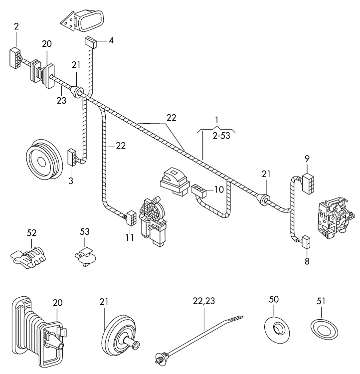

Yes I think I used a broad flat blade screwdriver . I think it went that there's a socket affair 2 on the car body side ,and just wires going through bellows 20 in the door side . So probably best to go for the door side and pull back the bellows there. Diagram as example.
