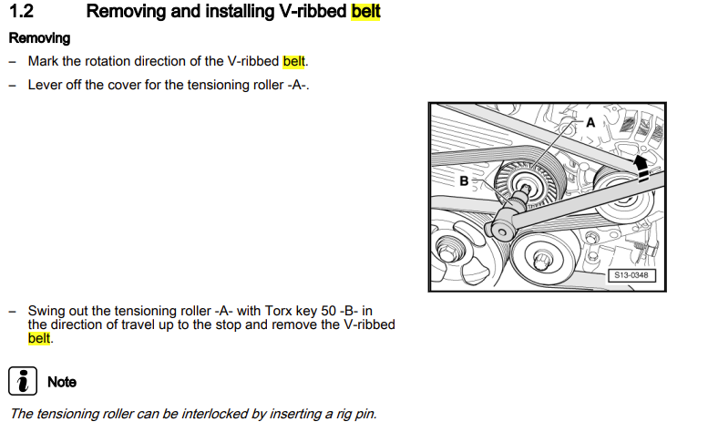

Photograph the aux belt routing, then take it off and run the engine briefly from cold without it. See if noise is still present. I suspect it may not be.
Coolant won't be circulating, so don't run it for more than a minute or two.
It's done approx. 70 motorway miles like this, to me it looks like the pulley/tensioner slapping around, however the noise is worse than I'd expect from this, there's no power loss or anything though. Kinda sounds like there's no oil in the engine but I checked the oil level already. I've changed a few accessory belts before on a different car where I pulled back the tensioner with a ratchet and slipped the belt off, is it the same?
  • Sponsor
Yep
Cheers I'll give this a go, I guess if the noise remains it's probably the timing chain and the cars toast.
