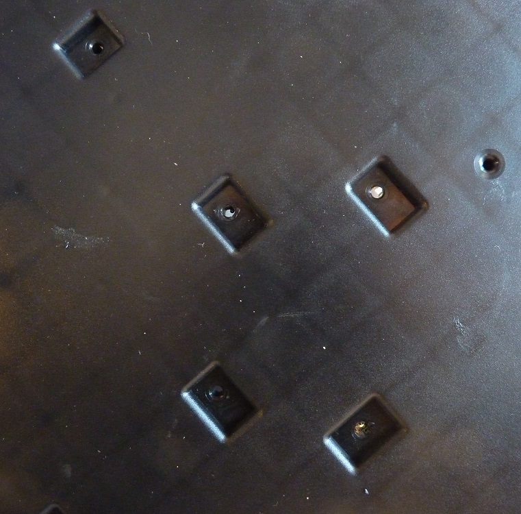

Soo, it was easier to drill out the 6 plastic rivets on the BCM, than try to measure on the connectors, that are so bloody short!!!
Its by the way pin 43 on connector A
And pin 16 on connector B

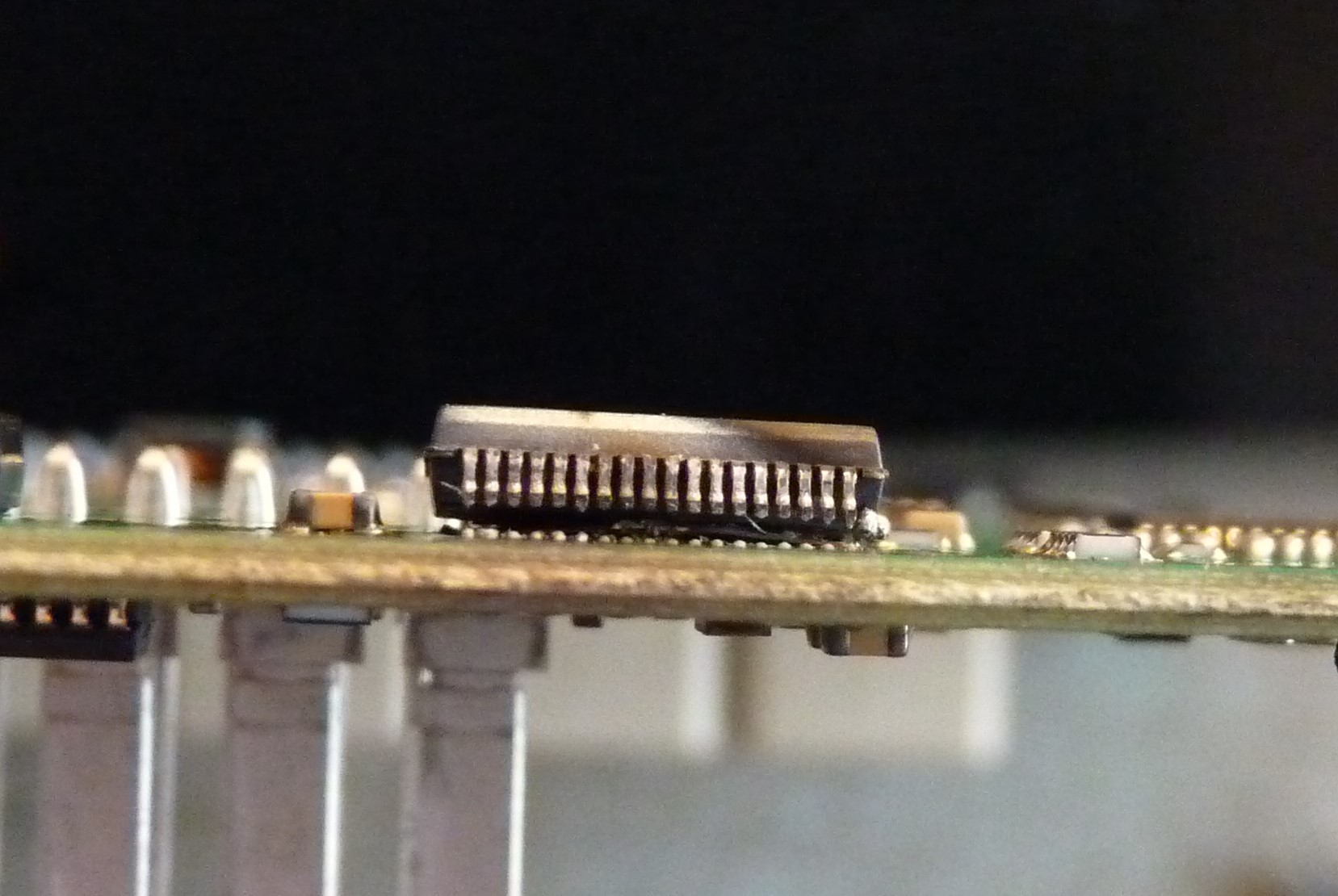

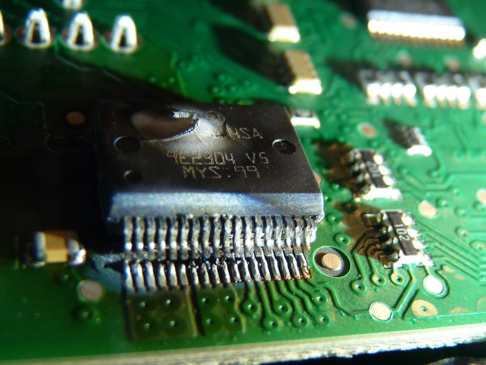

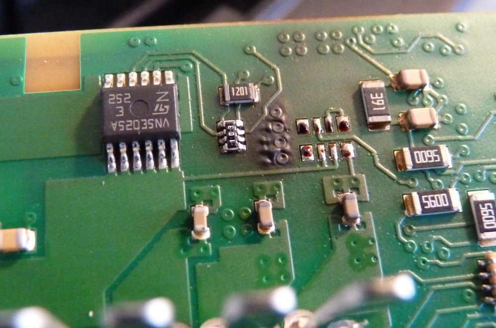

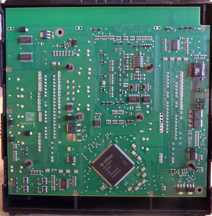

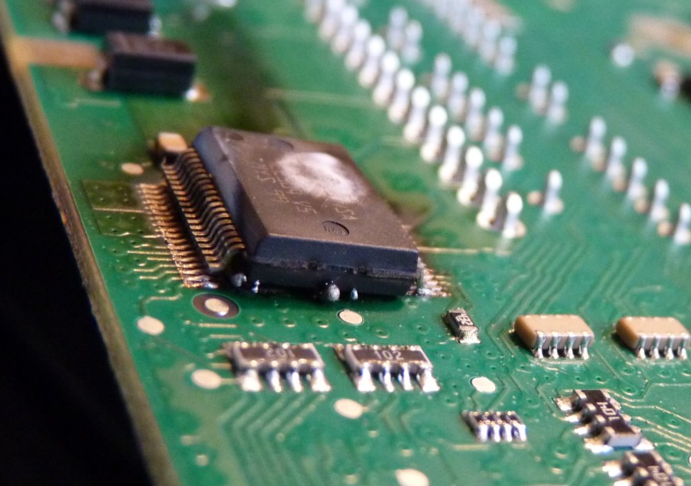

Well, after taking BCM off, it smelled of explotion 😃
Here:
4 pictures of the damage. One from other side. And one of the cover that needs to drilled off - what ever for it is wellded on is beond me????
And before getting the BCM off of the car, I checked if the bulb warning light lit up without brake bulb mounted and it did.
  • Sponsor
Wow, that went 'pop' properly!
I thought something like that might be found, but I was hoping it might look a bit more repairable than that does.
  • Sponsor
Was there a loose 8-pin device in the case, fallen off the other side next to the 'burntest' bit?
Edited by Breezy_Pete
No loose chips, no.
Currently trying to figure out what that exploded chips name is 😃 JUST in case it could be changed.....
Its conveniently half desoldered itself for you.
Its name might have been Freedom Fry!
Edited by J.R.
Yup and everything underneath is also loose and off the board. I need to order an other BCM.
