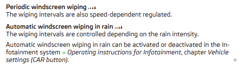

The other odd thing is that I'm sure the windscreen wipers have some intelligence. They won't come on automatically, but on intermittent I'm sure it makes some decisions based on rain level. Maybe I'm imagining it.

Wipers, yes the intermittent is based on speed and rain level, assuming you have auto wipers

The wipe hasn't got a rain sensor. They are speed related only.

Wipers:-
