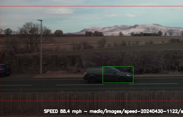

As I type this evening already
If anything I think this was under reading and he was still gunning it as he passed me, still another 600m of 40mpg  limit to go.
Not bad for a MkV Escort tbh.
Obvs a kittens though.
Can you get the camera and pi to recognise the car and sprinkle a few nails???

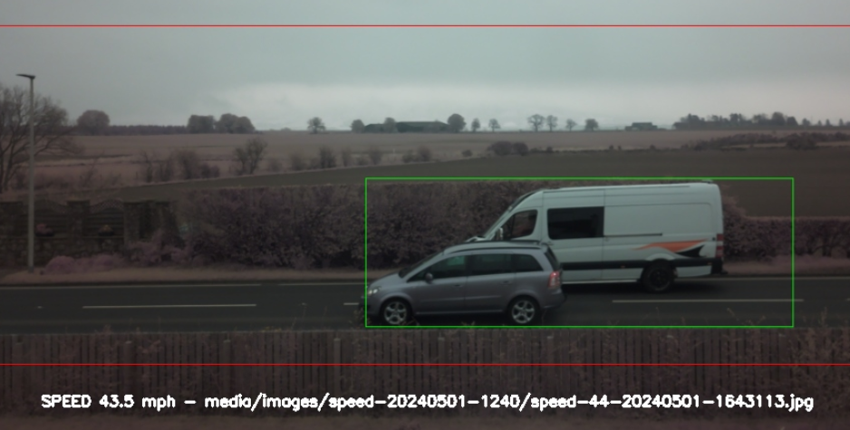

14 hours ago, Aspman said:
That Image has made me think.
If there are no parking restrictions on the road  a pair of transits (other vans are available)  strategically parked to form a chicane might slow the traffic down ;o)

eg for the handful your pi has caught “speeding” how many weren’t?
the Pi records all cars speeds above 17mph to generally exclude cyclists and pedestrians. The percentage speeding is significant but not the majority.
The app can chart by hour the average speed but also records each event. I'm working on a way to extract the data as a CSV so it's easier to plug into Excel.
It's not perfect and the AI can glitch where it detects more than one object on a vehicle, I've noted a few unlikely speeds (clocked a bin lorry at 88 but it was probably stationary or close to 5mph as it was collecting so the AI has glitch on an part of the image shape) but these are fairly minimal and generally obvious.
We actually have the data from the council monitoring but I'm not particularly adept at excel analysis. Can upload if anyone wants to play.
Edited by Aspman
