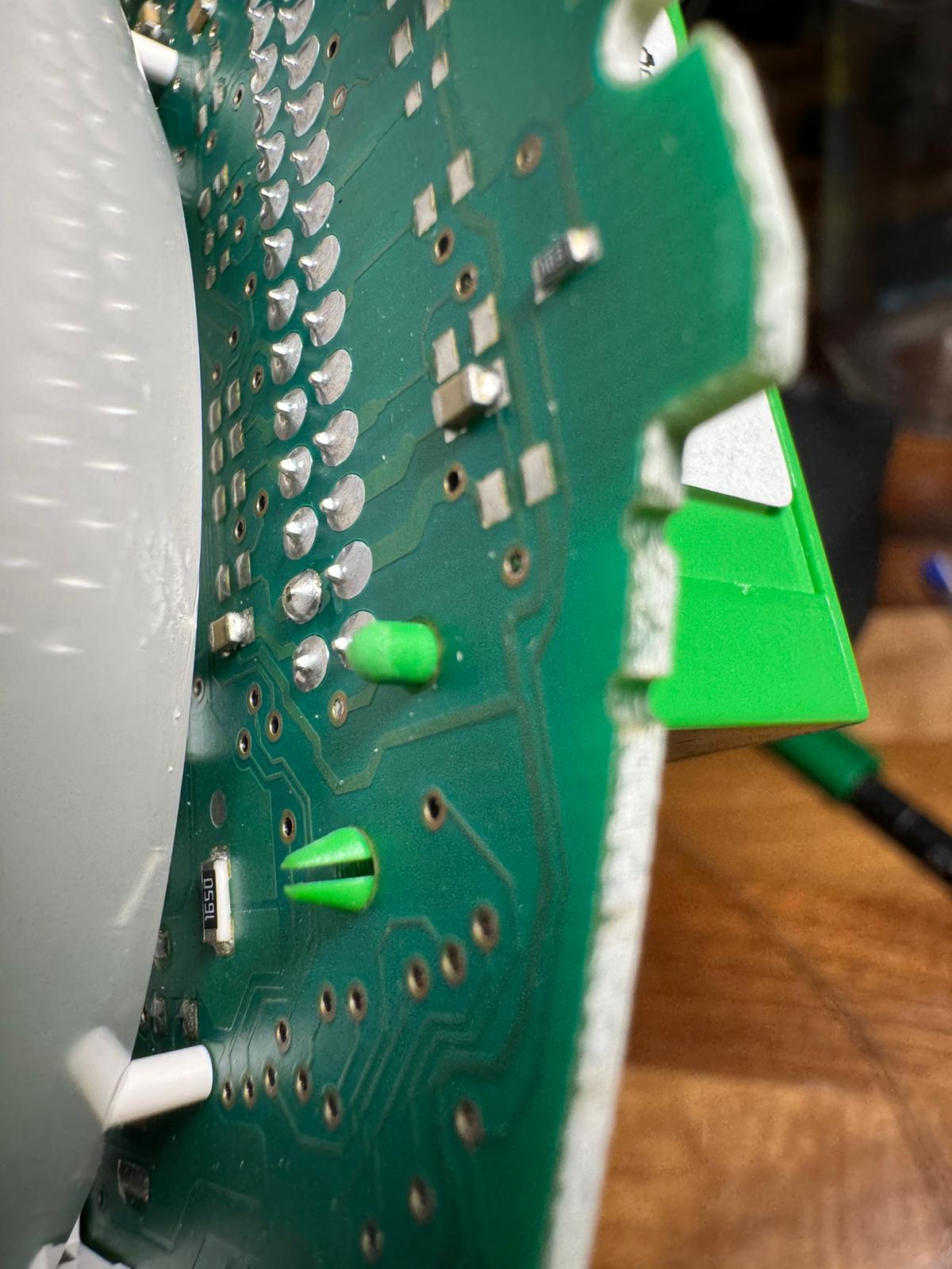

Hi, I got the cluster out and all the solder joints looked OK.  But I got my son to resolder No.15 pin but unfortunately this made no difference.  I remember reading that this problem can be caused by a bad earth to the  fuel level sensor.  And the fix I believe is to link the sensor earth to the earth of the fuel pump.  I will investigate this.
The image below shows the pins after pin 15 has been re-soldered.
  • Sponsor
The brown/white earth from the gauge should end up on pin 32 of that same connector, check if it does (and that pin connection, can't see well cos of the green peg.
HI, We had a good look at all of the pins and they did look OK including pin 32.
