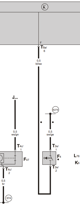

Still wrestling with this.  There's no current at the switch connector.  I checked both pins with the ignition on and the car in reverse.  Maybe there's a break in the cable somewhere?  I noticed some sort of small junction box before the switch connector but I'm reluctant to open this as I'm not sure what it's for.

I wonder if someone has repaired before, using a new connector with wires pre-fitted, and grafted it into the original loom at this box? In which case check within. I doubt it's part of the original car.
Thanks.  It looks original fit.  I guess the supply could be shared with something else.  A wiring diagram might help, do you know where I can find one?
  • Sponsor
The only junction shown in the wiring it the one labelled B279, which the key describes as "Positive connection -3- (15a), in interior wiring harness" [my bolding].
Grey box at top of diagram is the onboard supply control module inside cabin.
So both wires should run continuously into cabin, I believe. What colour are yours where they emerge from switch?
Diagram suggest they should be black/yellow from fusebox and blue/black to control unit.

Yes, I think those are the colours.  I'll have to remove the airbox again to make sure (maybe tomorrow).  Does this diagram show which fuse they are on?
  • Sponsor
Cabin fuse 4 feeds junction B279, as expected. it also feeds some other things, so I think it would be apparent if it had blown.
