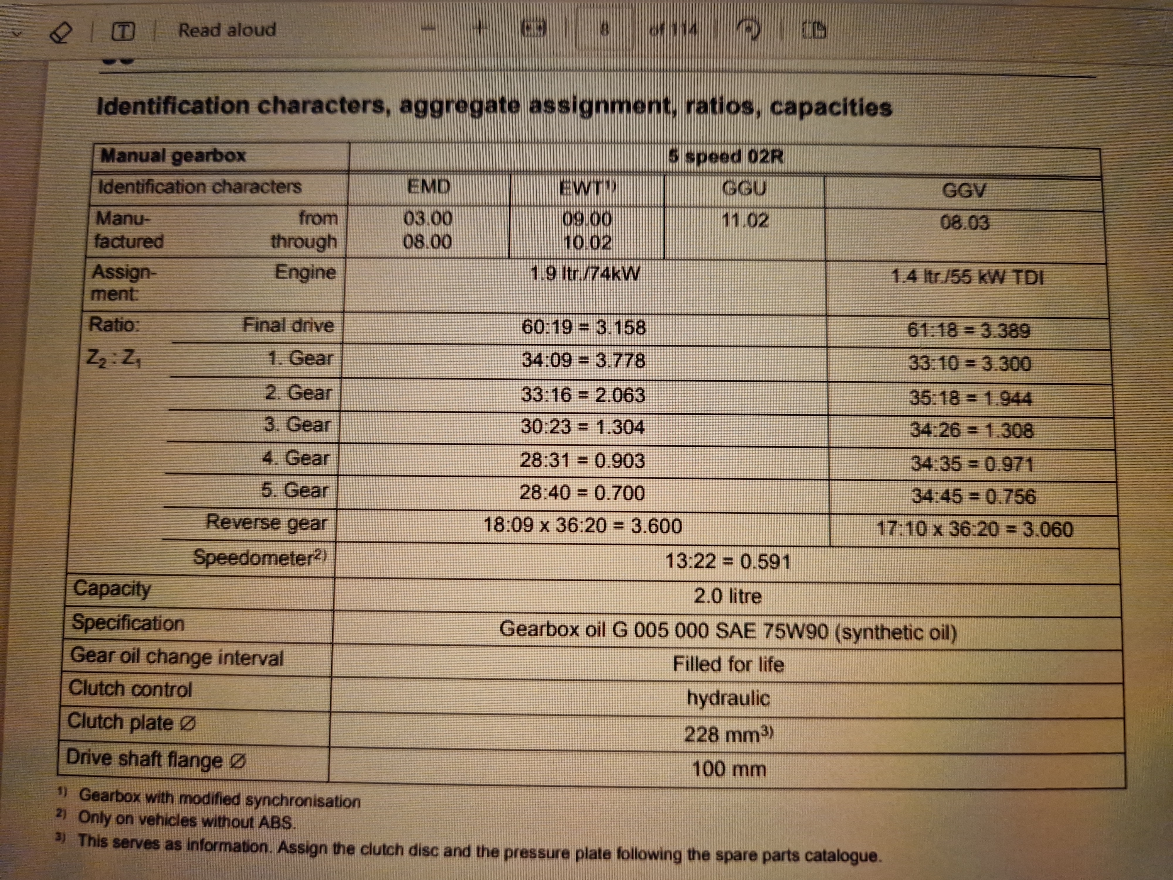

EMD and EWT codes were used before GGU on same engine, to widen search scope a little, maybe.
thats certainly going to open the options up!
