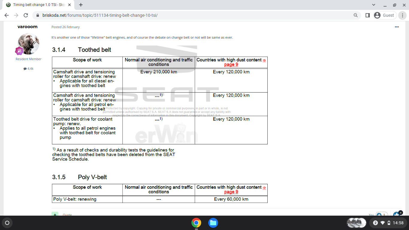

So really it is not a No Service Interval it is a long time in the future.    Which is amazeballs because just in June 2023 in the UK it was still 50,000 miles / 5 years and the rest of Europe / EU & dust free what ever they decided to give in Time / km,s.
Have Skoda now globally deleted the service schedule for belt replacement of 1.0 TSI,s since others have been told it was extended?
Are Tensioners for life not just for Christmas and leave until theu fail?
SEAT had deleted the Service Schedule back before February 2023.
Edited by Rooted
