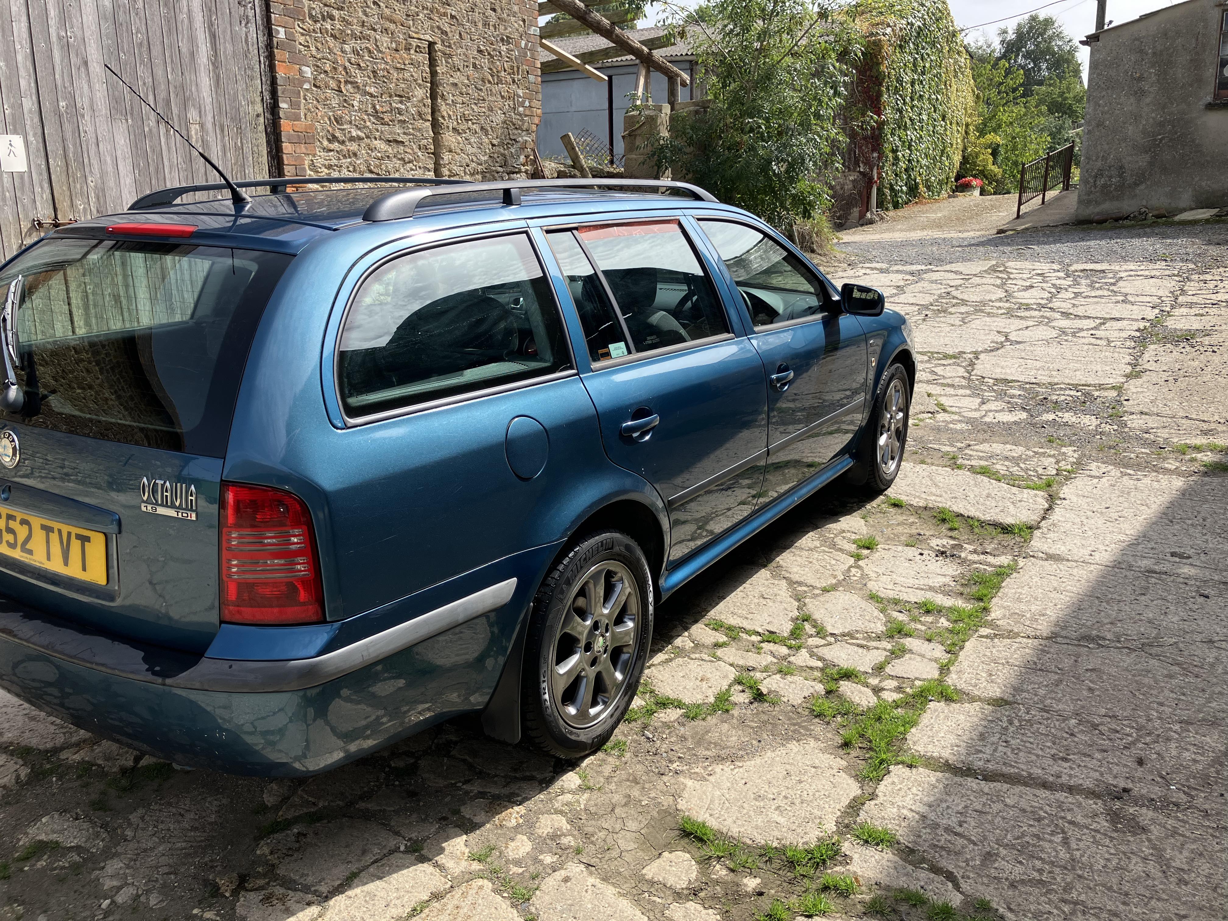

I have bought a L&K car with these wheels on. Do they have much value? In generally good condition with minimal lacquer peel etc.
I'm trying to decide whether to stick with these or sell them to put tyres on another set.

Hard to gauge as they don't come up very often. I'd guess around £200 to the right buyer.
I'd keep them on though! What would you change them for?

That's about what I thought. I'm selling the car they are pictured on (our old elegance) but intend on keeping the wheels to go back on the 1 owner L&K we've bought. Reason for swapping in the short term is the tyres on the elegance wheels are almost new whereas the L&K ones are 10 years old!
