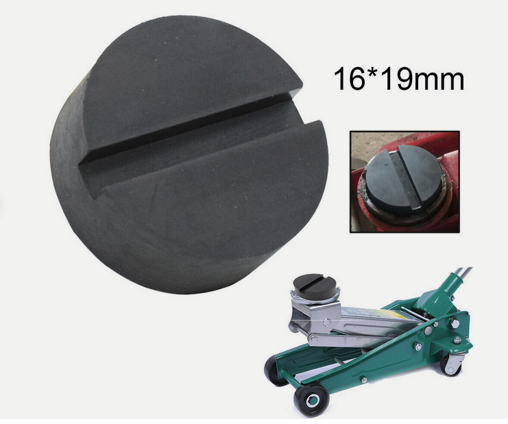

A rubber puck with a slot in it will stop your shiny new hydraulic jack making a mess of your sill. image.png.53a2b46c037278695cc067b28ae66d52.png

I got a couple of the following rubber pucks for my jacks (other, and better are available) they smell a bit but come in resealable bags, they seem to work well enough on my wife's 2015 Fabia and my neighbour's car. - https://www.ebay.co.uk/itm/404331002770
