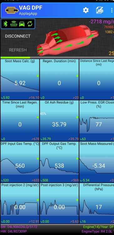

The dpf seems fine with 36g of ash, regens every 170 miles or so down to just over 5% soot. Differential pressure at idle after a regen is around 5m/bar.
I have changed and adapted  the G450 differential pressure sensor with no improvement.
The car runs and drives perfectly with no smoke or soot in the exhaust.
There is 77k miles on the clock and i am concerned the egr cooler may be partially blocked as this is apparently common.
3 bottles of dpf cleaner in the tank over the last few weeks hasn't helped.

Hi do you have the ability to read measured value blocks?. If you can what are the figures for measured and calculated soot?.
These are the figures immediately after a regen.
My local diesel specialist is pretty sure it's the egr cooler that is blocked with adblue crystallisation.
He's replaced loads of them.
