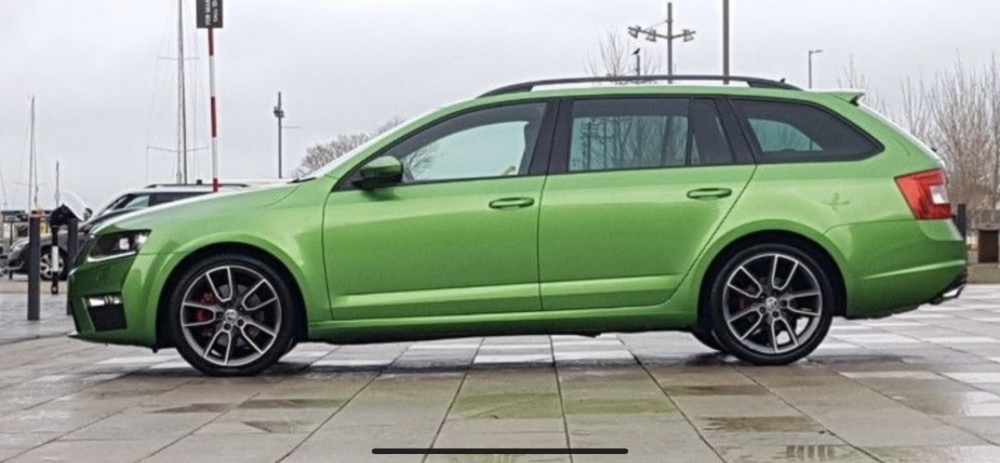

I have a standard Rallye Green VRS estate with the 18" wheels. I want to reduce the gap between the tyre and wheel arch at the front & rear so that the car sits level.
Can anyone recommend a set of springs to do this? I don't want the car sitting too low, and I don't want to upset the ride quality either.
I also would like the wheels to sit flush or just inside the arches so that the car looks nice and squat.
If anyone has a Mk3 VRS estate with this type of setup, can you please post an image on this thread.
Many thanks.
This is what the car looks like now.

The vehicle is not designed to be level, it should have the front to rear rake as shown in the photograph, reducing both the front and rear ride height unless by different amounts would not make it level.
Desiring the wheels (I presume you meant tyres) to sit flush or inside the wheelarch and not wanting the car to sit to low is a contradiction in terms.
I follow Carlsons logic by increasing the sidewall height of the tyres but I doubt you would notice a 4mm difference.
Larger rim diameter or larger aspect ratio tyres would be the only way to achieve what you desire, the former is likely to make an already hard ride much harder, the latter will impact negatively the handling and steering response/feedback.
Personally I think it looks just fine, its already significantly lower than a cooking version.

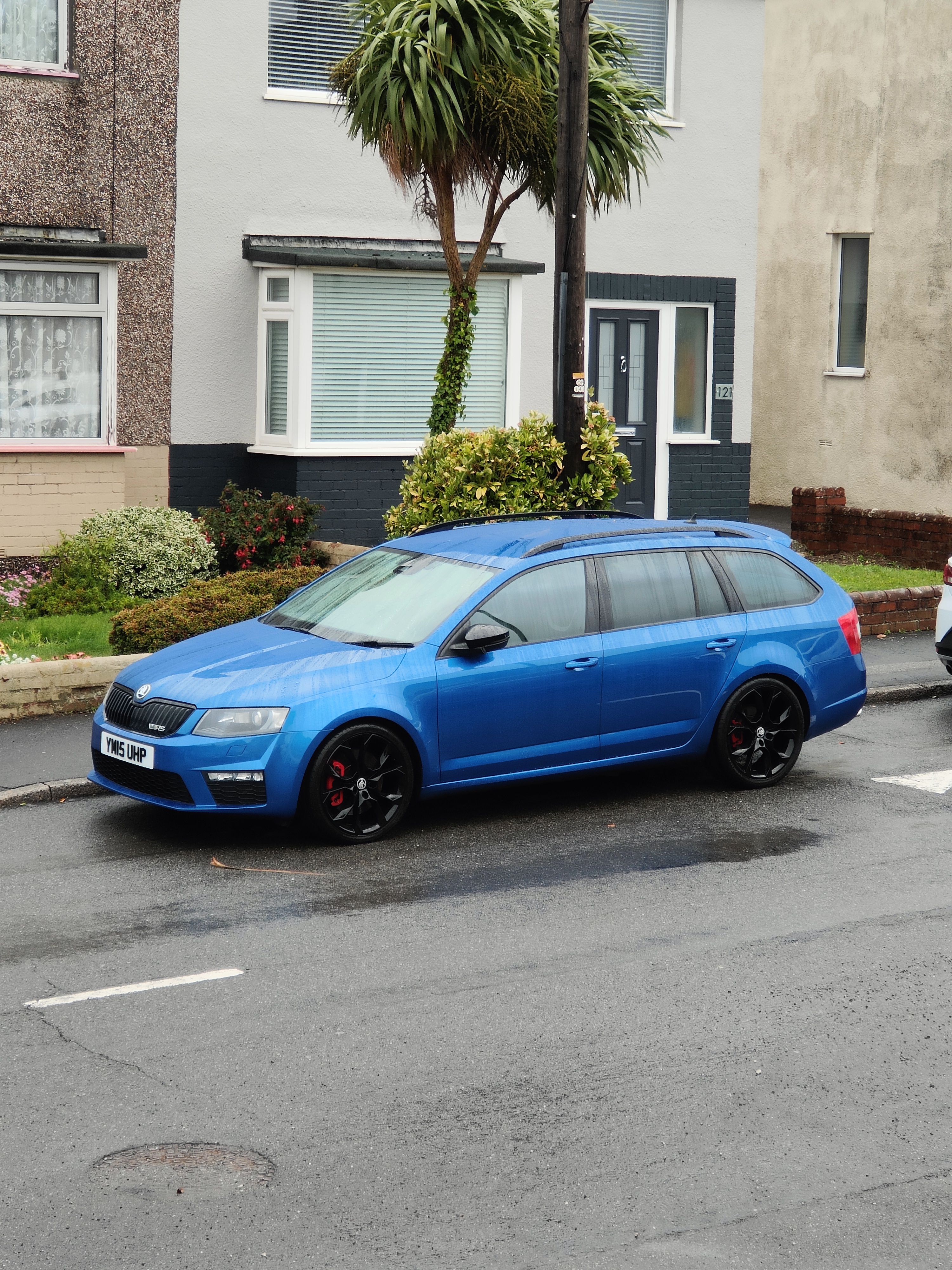

Not a great photo of mine, but I went through this same scenario.
I settled on Racingline 20mm springs. I think it's great and how it should be from the factory. I prefer the 'rake' you mentioned and in retrospect would have gone for the Eibach springs as above, this would keep the gap looking uniform front to back. The other option is 40mm H&R but these will be stiffer again. As great as they look, I reckon they would make it slightly impractical and scrape more.
With even slight lowering springs you WILL have a stiffer ride but I don't think it's awful. I combined mine with Bilstein B4s but I think if you went for a fancier shock it would retain more of its comfort whilst being supportive and handle well. Bare in mind that springs are a small part of the suspension. My shocks were heavily corroded and leaking at 88k so to get the best out of it, prepare to change alot of it. I had to cut off the track rod ends and ARB droplinks due to corrosion. I ended up replacing shocks, springs, topmounts, ARB droplinks, outer track rod ends and bottom ball joints.
As for spacers, on the pre-facelift 20mm at back makes it sit nicely (the facelift has a 19mm wider rear track so you are not upsetting handling) Loads put 15mm on front but to me this looks daft and far too much. At a push I would go 6mm, 5mm or 3mm and this would give you that uniformity with the rear in terms of how it sits in the arches. FYI the photo of mine below shows springs and just rear 20mm spacers, I want to fit front spacers (and tried 15mm and didn't like them) but haven't decided on a size yet. Im tempted by 3mm so as not to ruin the scrub radius too much and avoid having too little hub to mount the wheel on.
Just remember than you can't fit any less than 17mm spacers on rear and 13mm on front for hubcentric due to the depth of the hub. If you go smaller, you'll have to fit non hubcentric spacers and anything over 5mm I would add hub extenders (eBay or Awesome GTi do them for £30ish) and longer bolts regardless.
Mine has 19s but 235 profile so as the guys above have mentioned, maybe a bit more height than 225 too. Comfort is fine, handling is great for the weight of the car for fast road use. I definitely wouldn't want it any stiffer!
