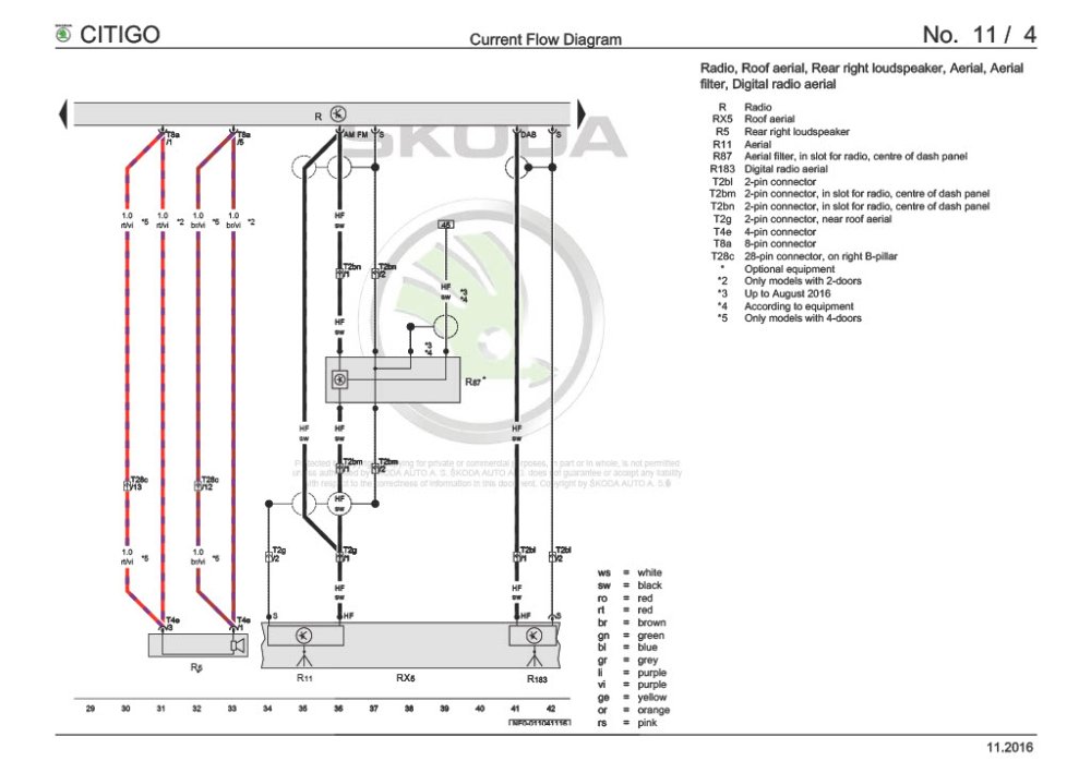

The wiring manual suggests one integrated aerial RX5.  Comparing the wires at the back of your radio to the diagram should give you an absolute answer though.

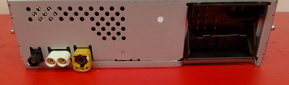

I've reached out to a couple of VAG retrofitters to see if they have any experience. One thing I noted looking at used head units on ebay though...
I looked at a unit from a 2018 up with a part number of 1S0035869B. Appears to look the same as other Skoda units but the rear appears to have an extra port

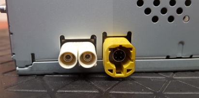

On the facelift Skoda units I've seen (part number 1ST035871A)
It looks a bit different
Wondering if the black port is for the DAB antenna and all the Skoda units I've seen thus far are FM/AM only.
Confirmed by a VAG retrofitter
"DAB uses a black FAKRA connection. AM/FM uses the white double FAKRA connection. The mustard coloured one is for the USB/Aux if fitted" - so you definitely need that extra port for it to be a DAB unit.
I think I've found the part number for the DAB capable head unit now as well 1ST035869B (Skoda variant).
