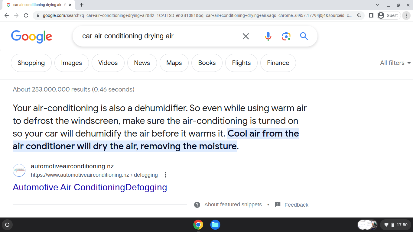

'Climate Control etc,    & Air Conditioning.   Not just refrigeration.
Many vehicles designed and built in Central or Eastern Europe are damn hopeless at demisting, and yet there are manufacturers very good at it and it does not even have to be expensive cars, even ones without AC.

I have not watched the video but know that cannot be true, when you use AC for heating it first chills the incoming ambient air to close to zero°c to dehumidify it then uses the engine heat through the heater matrix to heat it up again to the desired temperature.
It will be using at a minimum twice the energy (hence fuel) than heating alone without AC.

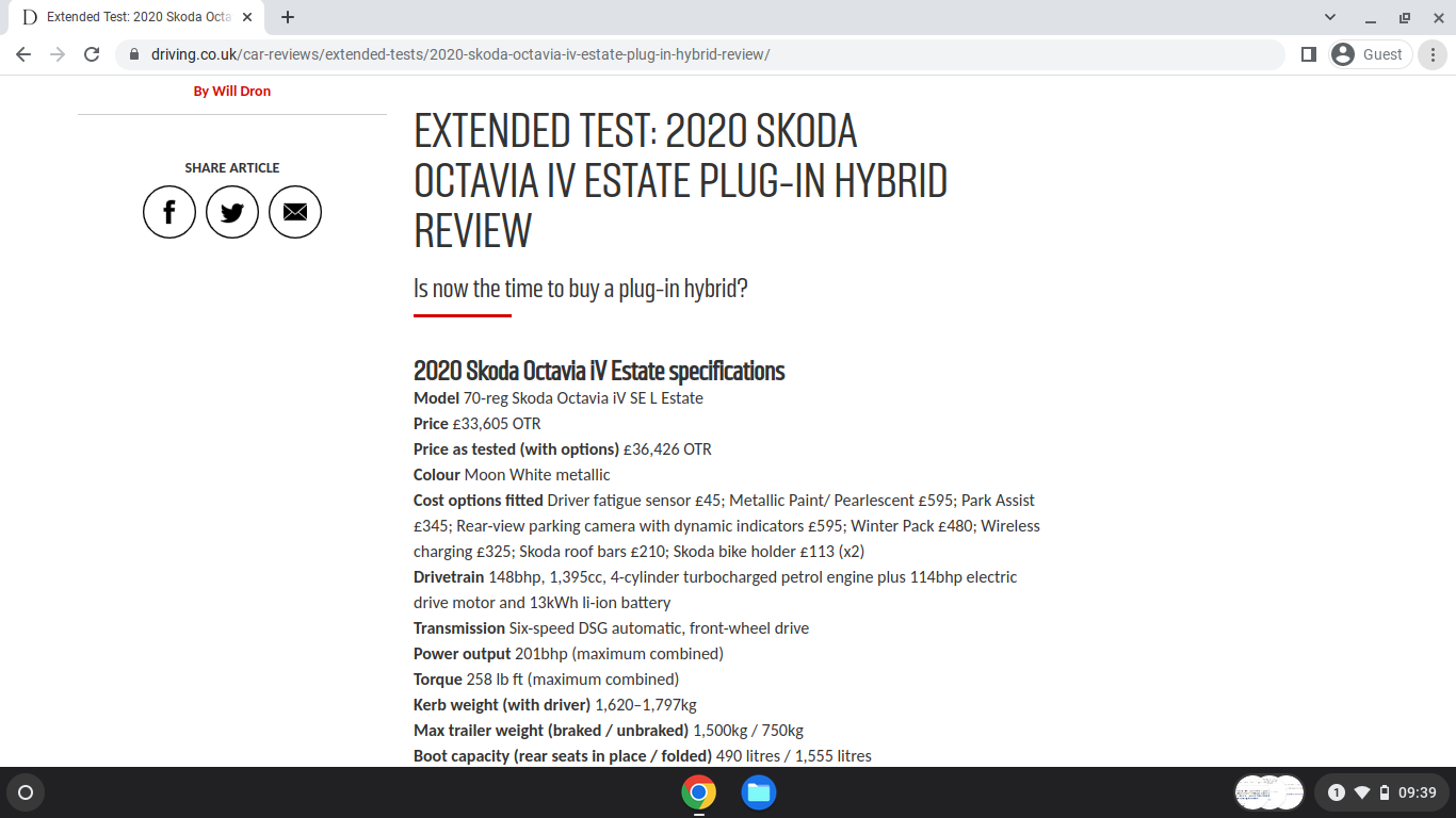

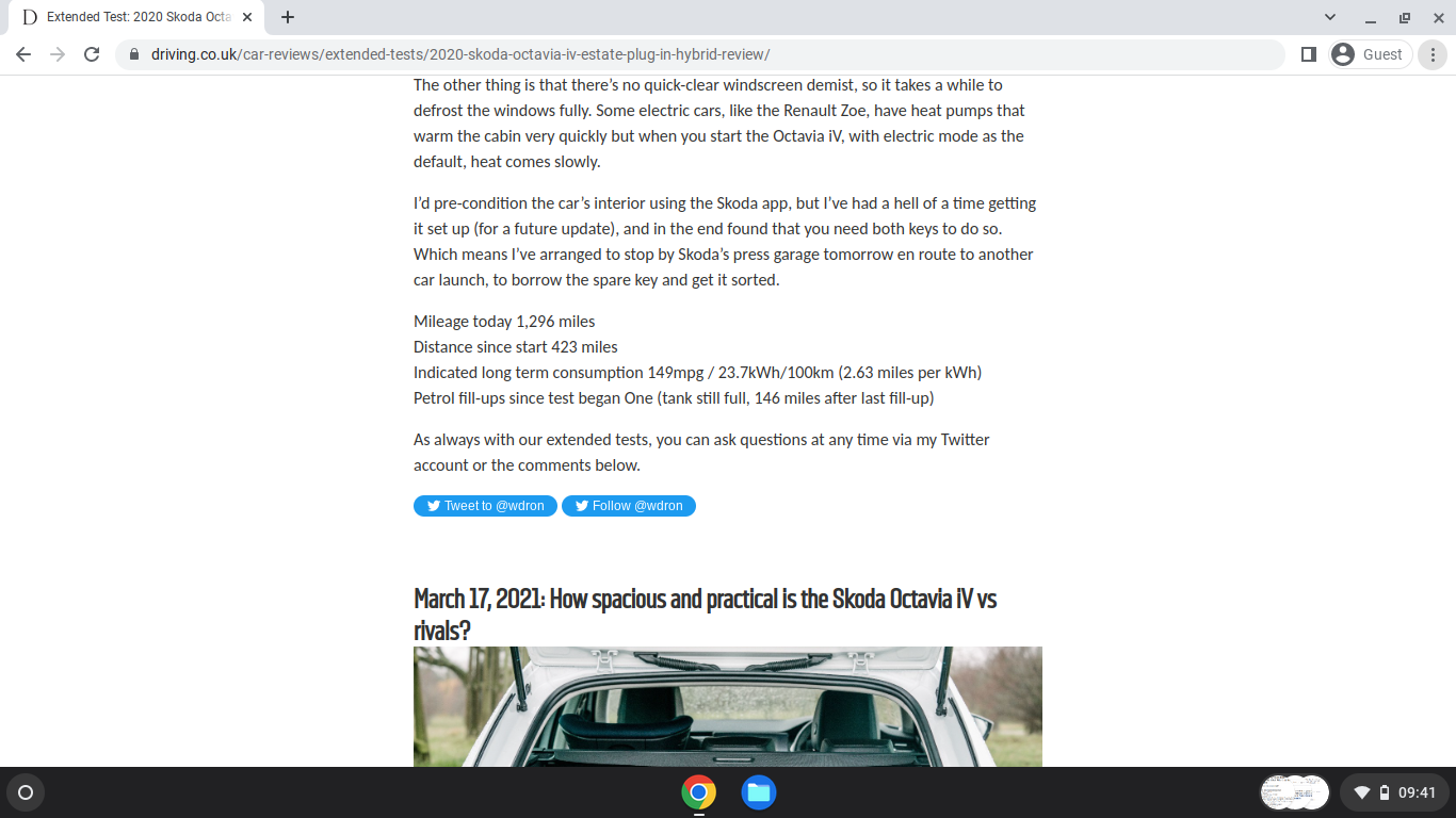

The OP has a 2023 Octavia iV PHEV.    Lovely to reminisce on the good old / bad old days but really he / she will find out soon enough what he needs to be using in Scotland this fine Winter to be comfortable and see out the windows.

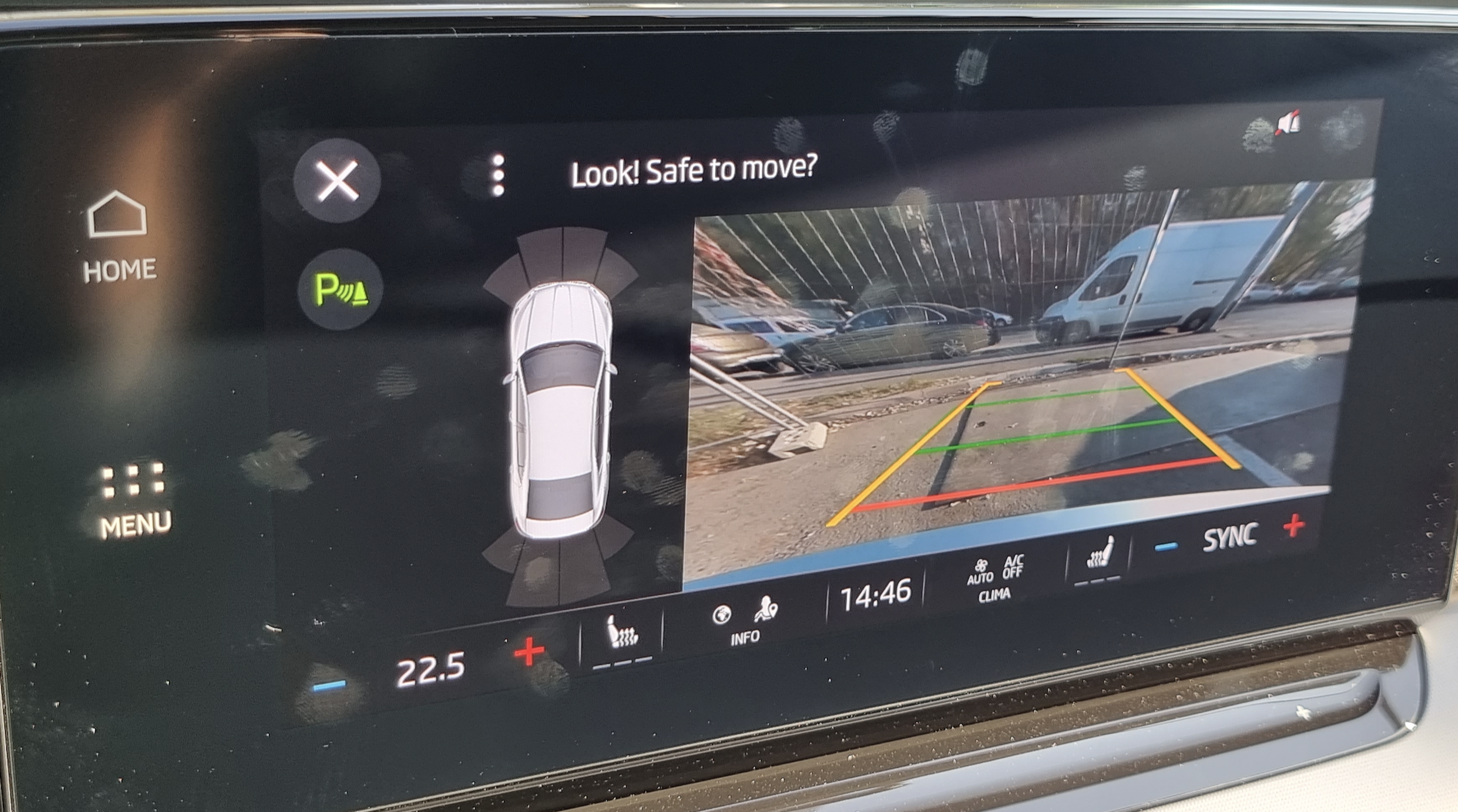

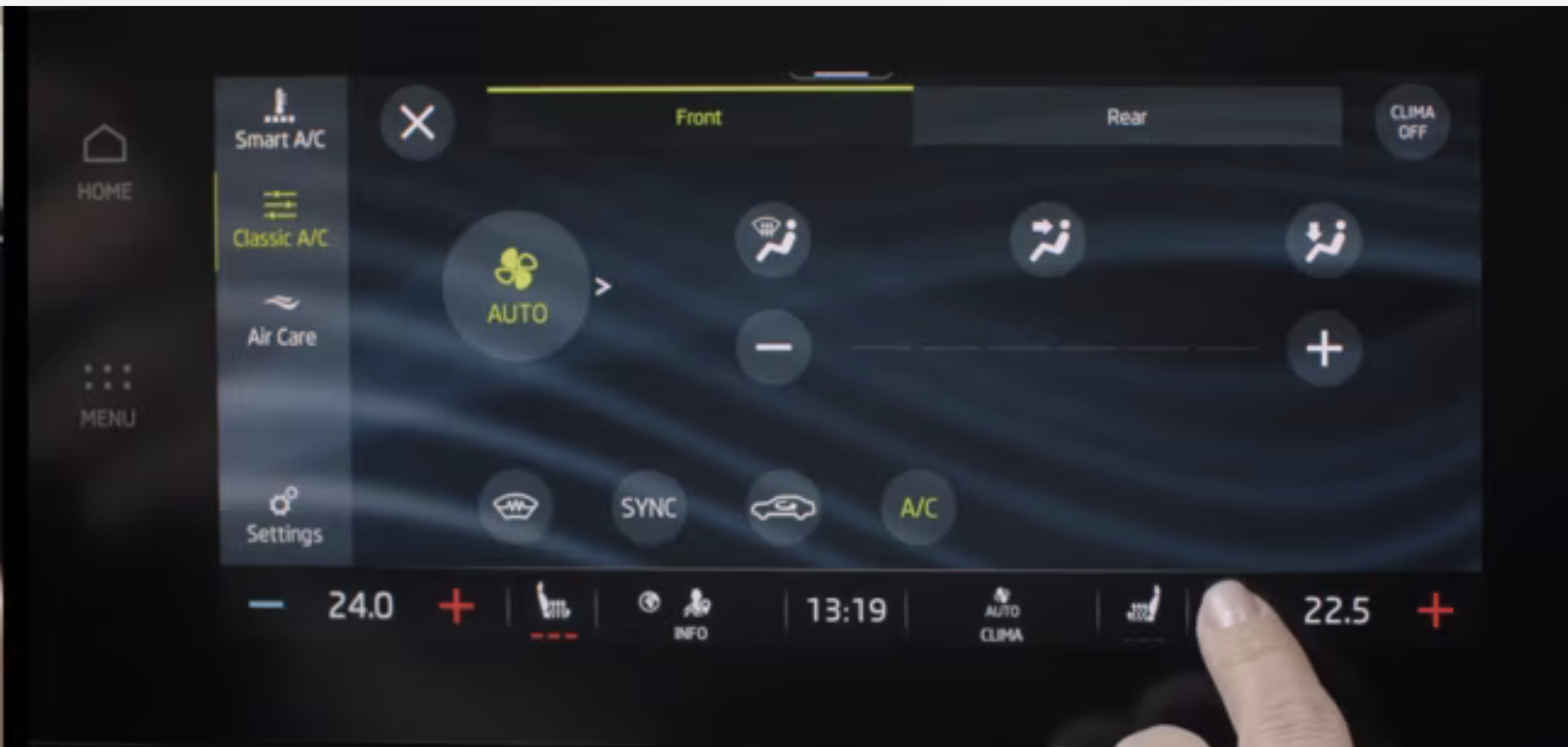

It could be the car he uses in the test doesn't use the A/C compressor for hot air. This is why I asked my original question - how can you make it just blow air without the A/C?
- go into the Clima Menu (physical button press or click/touch on the "Clima" text on the bottom of the screen)
- go into "Classic AC" sub-menu (see picture below)
- click the "AC" round button in the lower part of the screen - the one next to Air-recirculation and temperature-sync.
If it's green - AC is on, if it's white - AC is off.
When AC is Off, you'll also see a notification (AC OFF) in the bottom of the screen in the black square "Auto CLIMA" - the one next to the clock... see 2nd picture.
