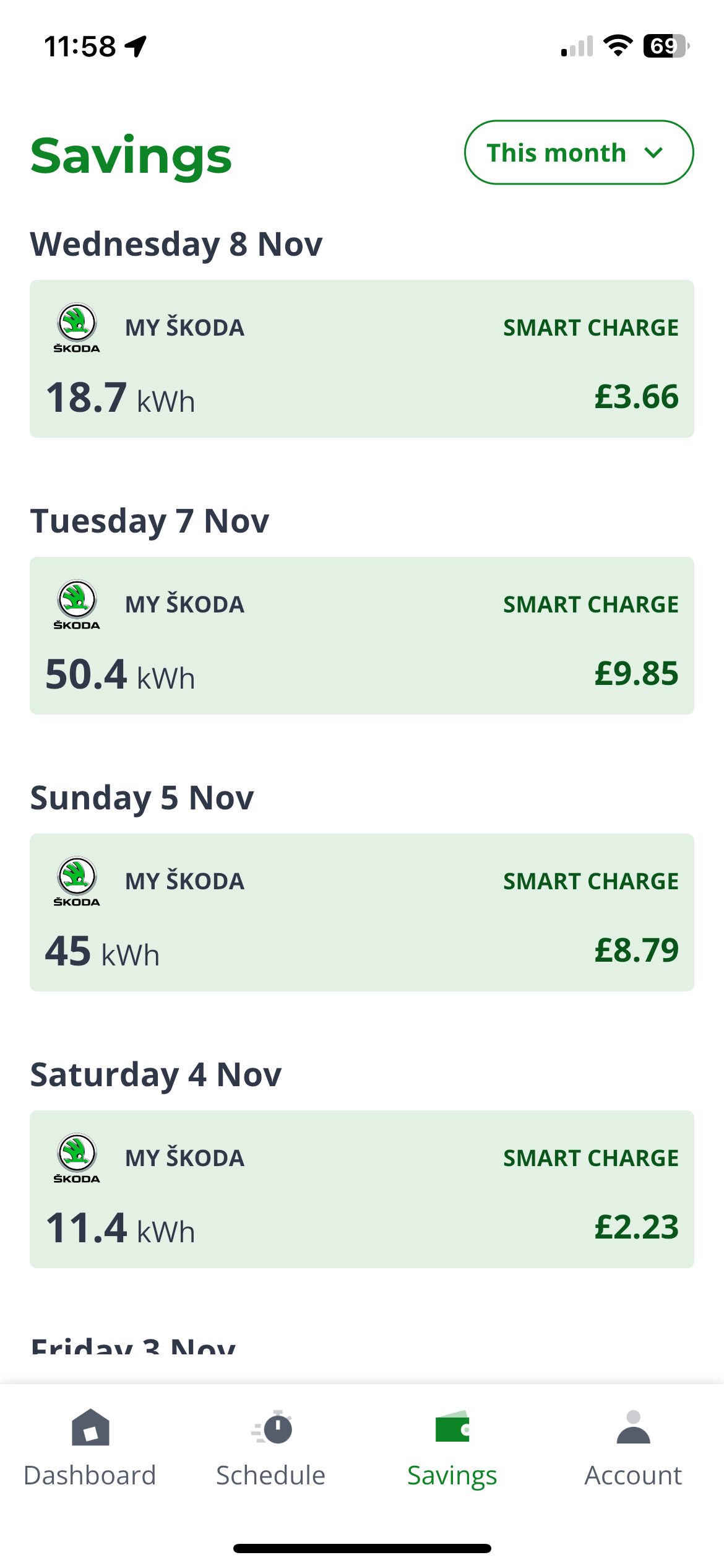

I’m confused. The battery capacity on the iV is 13kWh, yet when I charge it using the OVO Charge Anytime app, I see charging sessions well in excess of this, often to get the battery to 80% charge. The highest I’ve seen, for a full charge, is 78 kWh. I’m not complaining, as Charge Anytime credits my bill to apply a lower rate for all those kWhs, but I’m not sure what I’m missing.  Surely a full charge should be 13kWh?

Thanks for the info. Your explanation re chemical process makes sense. The charging time has always been quoted as about 5 hours, which is how long mine takes (using a 3-pin plug), so I assume all is in order.  Just seems it’s costing me more than I’d realised.

Definitely a figure for each charger by session…

The car is capable of pre-heating, but I only ever use it when the car is plugged in.  I don't think this power would register on the app, as it controls when the car is charging, thus tracking what to the apply the lower tariff to.

Thanks, that's the sort of knowledge I'm lacking.  Will check actual usage on my account.
But how are those measured?  What physical equipment is installed to assess the power passing through your granny cable?  If those are figures from the app then is that talking to your car or via a smart plug?  Does it have a more detailed view than a simple total figure, like a start end end time and rate during that time?

So the day-by-day usage on my account (for all electricity) is significantly lower than the Charge Anytime app is showing.  This is quite a relief!
As I understand it, the app is granted access to my Skoda Connect account, so can control when the car draws from the granny cable.  I had assumed the car could therefore tell the app how much it had consumed for any given session.
Sounds like there is an issue with the backend somewhere which is causing the wrong data to be displayed.  The fact you are being charged the correct amount shows you are receiving the correct amount and that they are controlling it correctly.
I would report it as a bug and keep an eye on it.
