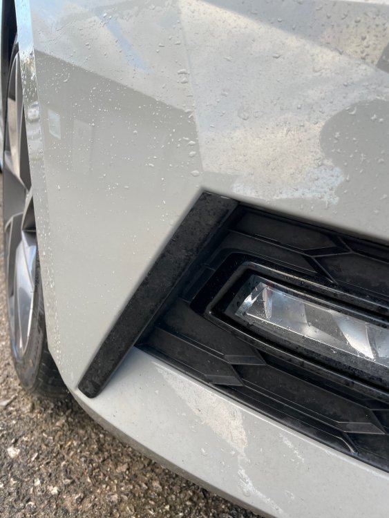

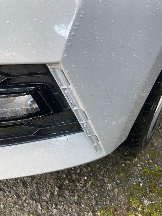

Also, I appear to have lost one of the small black trims from near the fog lights (see pictures) ironically the remaining one I noticed was loose while cleaning and was going to look at fixing better. Does anyone know a part number or at least what it would be called and where would be best to source one?

HI, you should be getting onto the dealer that sold you the car about the leaks, my intial thoughts would be sunroof drains.
I think the part you are looking for is 'Cover Trim- Right' 3V0 807 834 B F9R, but check first with your dealer to be 100%, it's about £25.00.

Sorry should read 3V0 807 834 B F9L,

 Thanks for the part number, found online for around 30 euro so will ask the dealer about supplying one.
