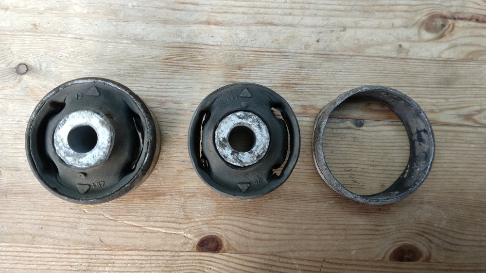

The bushes need removing from / refitting to the arm using a hydraulic press.
The O-S one is in two parts being the middle and right bits in the photo above.
There were some knocking marks on one part of the outer metal ring where it was hitting the subframe.
The part on the left is from the N-S and is also showing signs of delaminating.
Note the triangular arrows on the rubber parts need to line up with guide marks on the arm, and when fitted one points to the front bush and the other towards the back of the car.

Just one comment, as you have not made this clear, there are 2 voids in these mountings and they are both different sizes/shapes, so, as well as making sure that the arrow points in the right direction/ orientation, the correct shaped void needs to be on the inner side and so on the outer side. VW Group, well at least VW, describe them in maybe a strange way - ie in using the shape of the voids to differentiate between the 2!

Correct, forgot to mention that bit.
