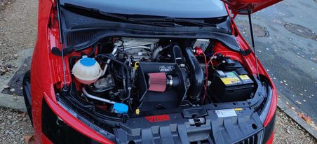

Following my first post that I made a little over a year ago, the project is progressing quite a bit!
Here's where I'm at, engine preparation:
- Turbo 1.4l TSi Hybrid RTMG
- RTMG Dump Valve Kit (my old Dump Valve is for sale for those interested: Forge Motorsport FMDV1 Red 1.2/1.4l TSi)
- MST Performance + Inlet full admission
- APR Performance coils
- NGK Iridium spark plugs
- Complete 2.5' line with decatalyzed valve (formerly just a half full tube line with valve) made by ProWeld in France
- SACHS PERFORMANCE reinforced clutch
- Carto Stage 3 Full E85
- (Soon) Large volume intercooler (Installation and adaptation) + Custom Sural (Airtec Mk2 vRS targeted)
Chassis preparation:
ST Suspension STX coilovers (already done in the first post)
(Soon installed) YTB Brakes front & rear big brake kits: Brembo 4 pistons / XTRA 312mm & Audi TT Mk1 disc: 280mm / Full Ferodo DS 2500 pads / Avia hose / Motul RBF 600 + Hard Race master cylinder reinforcement
- (Soon) Full PowerFlex Silent Bloc Black chassis
- (Soon) Hard Race chassis reinforcement:
- Central lower reinforcement
- Rear torsion beam reinforcement
- Adjustable front stabilizer bar links
- Added 24mm rear stabilizer bar
- Front stabilizer bar 28mm
- Front lower anti-ratio bar
400654906_1731882077307749_3542153157172029885_n.jpg.51cbf4337a7d8a112d83c125cb2c3ed7.jpg400736757_1429262471269419_164880737870204920_n.jpg.34020aa979598f05f3fb513e9a6eadd0.jpg394431093_310862825111869_2506570616868426768_n.jpg.0ea4ade3711965af77aba39dc9164aed.jpg369627241_644896481157668_3517227560226247346_n.jpg.daaf71a93069525126a6dd3bf156a22c.jpg
Michelin Pilote Sport 4S (18’) | Borbet Y (summer)
Hankook Winter I*cep (17’) | Bola B26 (winter)
If you have any questions, don't hesitate :D
