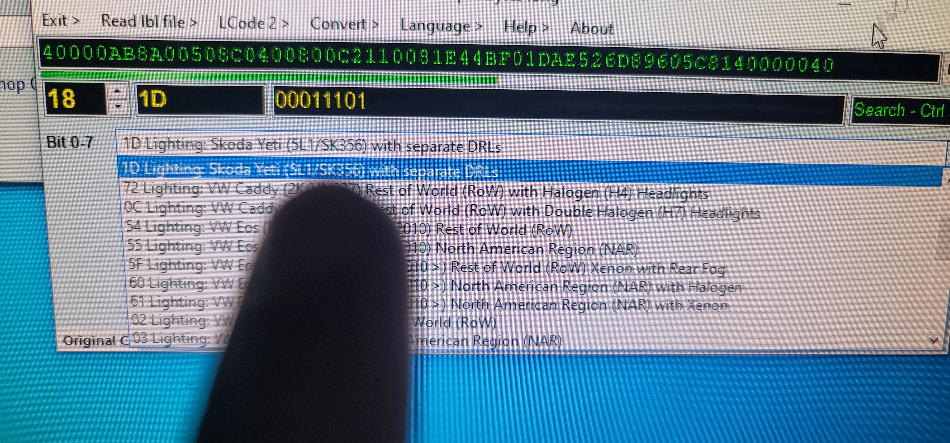

Hello everyone.
I have a 2014 Skoda Yeti, 1.8 4×4.
the model pre the facelift.
I changed all the halogen bulbs in the car to LED bulbs.
And even though they have CANBUS, I still have warning notes on the dash screen.
I have the VCDS module, and I would like to use it to erase the error codes.
I understood that it can be done through byte 18 as shown in the picture.
I don't know how to erase the existing code and reset the warning lights.
I thought of clicking on the Lightning reset option.
Does anyone here know if this will actually solve my problem, and is it safe?
Thanks in advance.

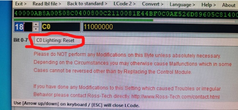

There used to be a massive warning regarding byte 18 so I wouldn't suggest messing about with it.
To fix the bulb out warnings properly, you'll need something like VCP or ODIS which can directly edit the lighting EEPROM. VCDS cannot do this :)

That depends what your original byte 18 value is.
If it's 00, it means none of the 'defaults' are completely correct for your car and you should not change it.
If it's some other value, then you can probably restore the config by changing it back to the default. Still - some people have had issues even after restoring the original value which is why it has such a large warning now :)

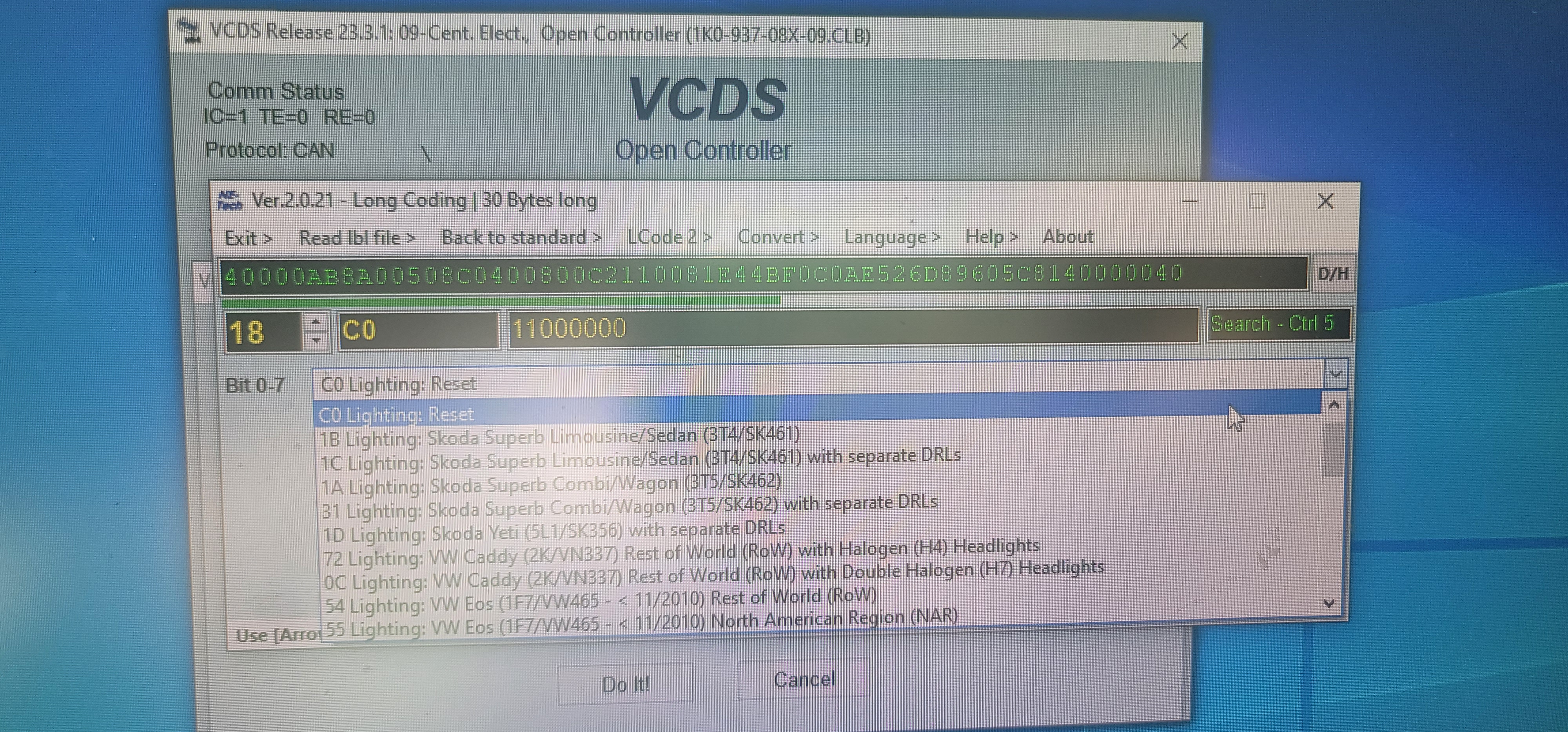

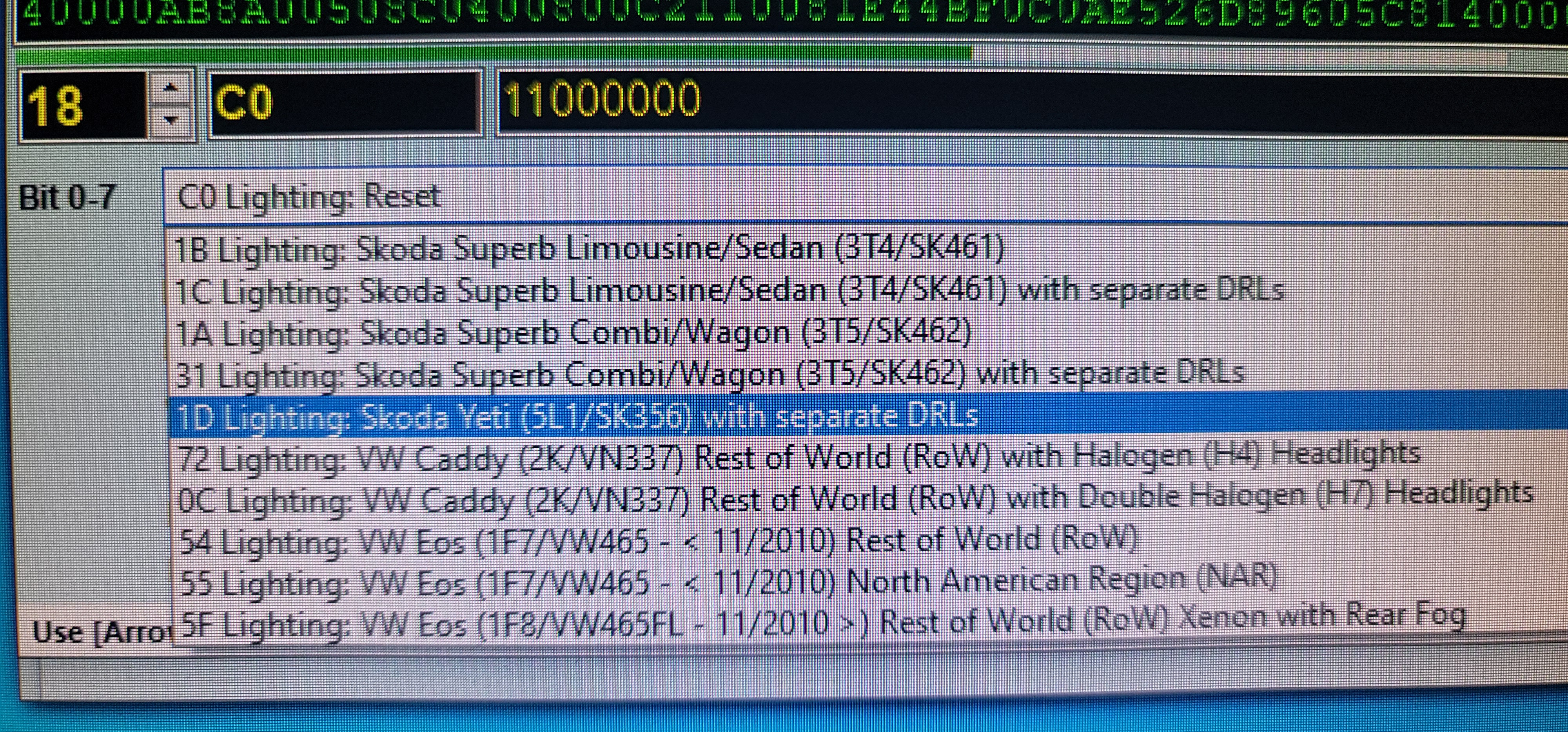

The dropdown menu of the byte 18 contains many car models, besides the default that already set to 00000000
I guess this list was created specifically to be a backup in case of failure.

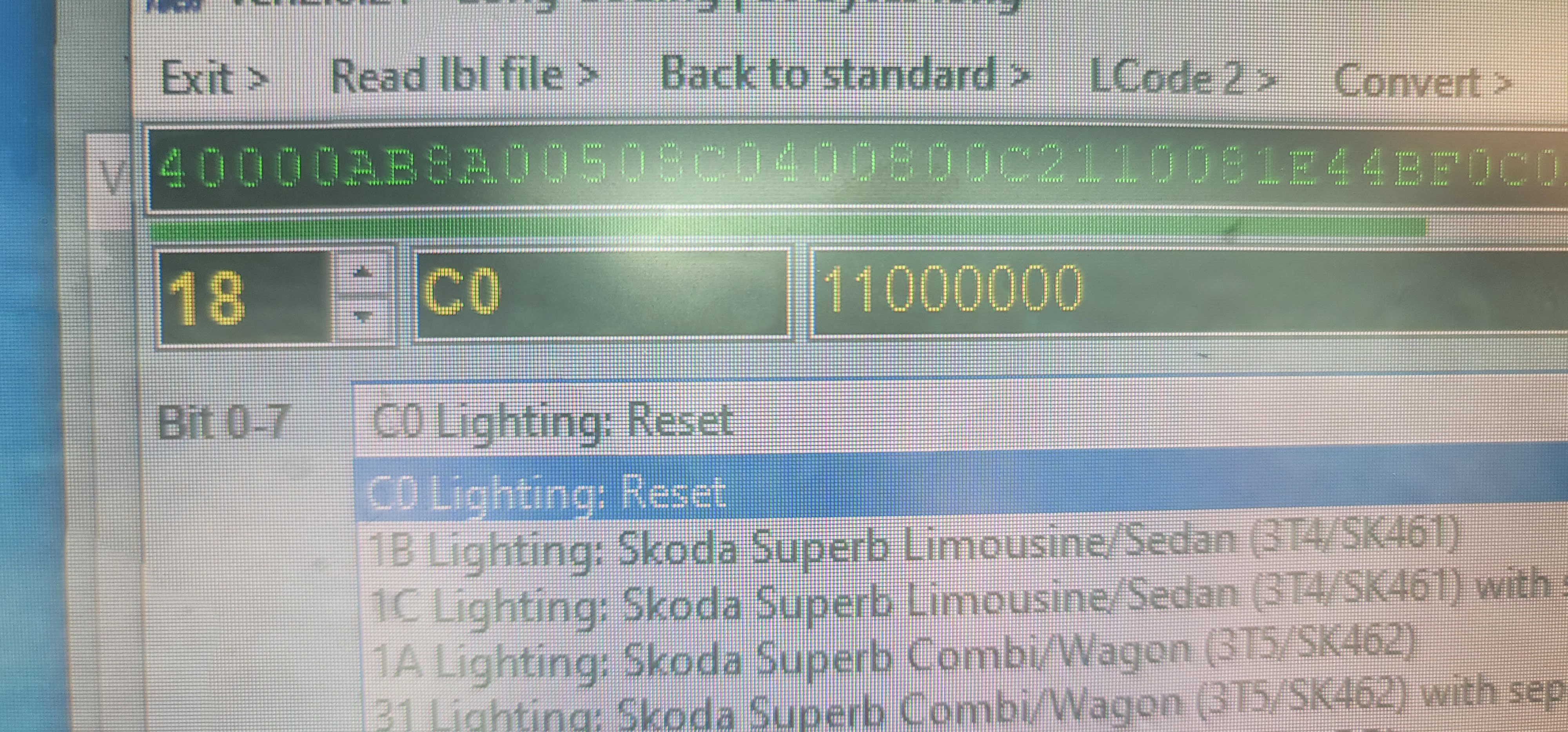

I was thinking at the moment to choose from the list the "Lightning reset" option.
hoping that it would reset all the fault codes, anif it will not  it didnt work properly,  I can always go back and select the Skoda Yeti 5L line that appears on the list.
am I wrong?
All I can do is repeat myself. If your stock byte 18 is 00 (00000000) don't mess with it!
The lighting configuration on this age of car is mostly contained within some 40-50 bytes in the BCM EEPROM. If you set byte 18 to a non zero value, it will overwrite this section of EEPROM with a new configuration. If your stock byte 18 is 00, this typically means that none of the byte 18 values contain the correct lighting configuration for your car and instead, the factory tool had to set the lighting configuration directly in the EEPROM. If you change it, you CANNOT get the original configuration back using VCDS as it's unable to directly access the EEPROM.
Just as an example, the Yeti came with multiple lighting options which would require different configurations and yet there is only single byte 18 option for a Yeti. I would expect 1D is close to your original config but given your byte 18 is 00, it will not match it identically.
As for 1C, I expect that just zero's the entire lighting config. It will not clear lighting fault codes...
If you really want to mess with the lighting config, you need VCP or ODIS as they can backup the original config and allow targeted changes to each lighting channel.
I have nothing more to add. You've been warned so good luck 👍
  • Like 4

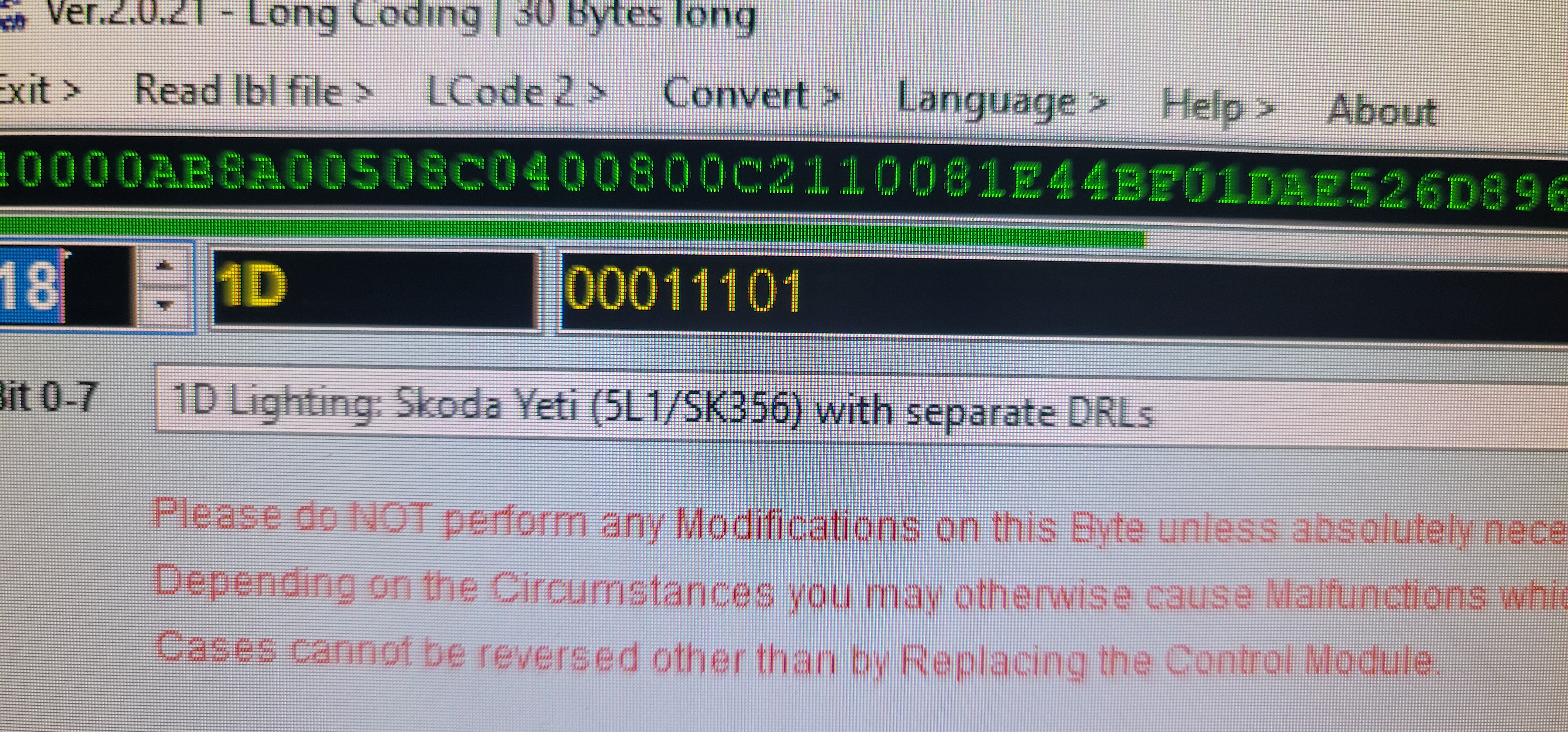

Yesterday morning I already made a change in the settings.
The original value that arrived from the manufacturer, indeed was EEPROM 00000000.
but I changed it to the D1 Skoda Yeti 5L that appeared in the list.
After I made sure that is fit the configuration of my vehicle, pre facelift of 2014.
And after I made the change and save and set the car on that parameter, I must say that I checked thoroughly and all the lights are on as usual in an optimal way.
all work well and as usual.
Of course, the fault codes of the LED lights that were before the change remained as they were.
The question is, whether this means that I have indeed found a reliable backup for my lighting code, Can I rely on it for any change any wrong case?
Assuming yes, how do you think I should make the change in byte , in order to try to cancel the error on dashboard screen,  should I simply insert a randomly binary code, to save the existing LED lighting condition ?
Or  maybe I just have to select the:  "C0 lighting reset" option and then click Do it.
