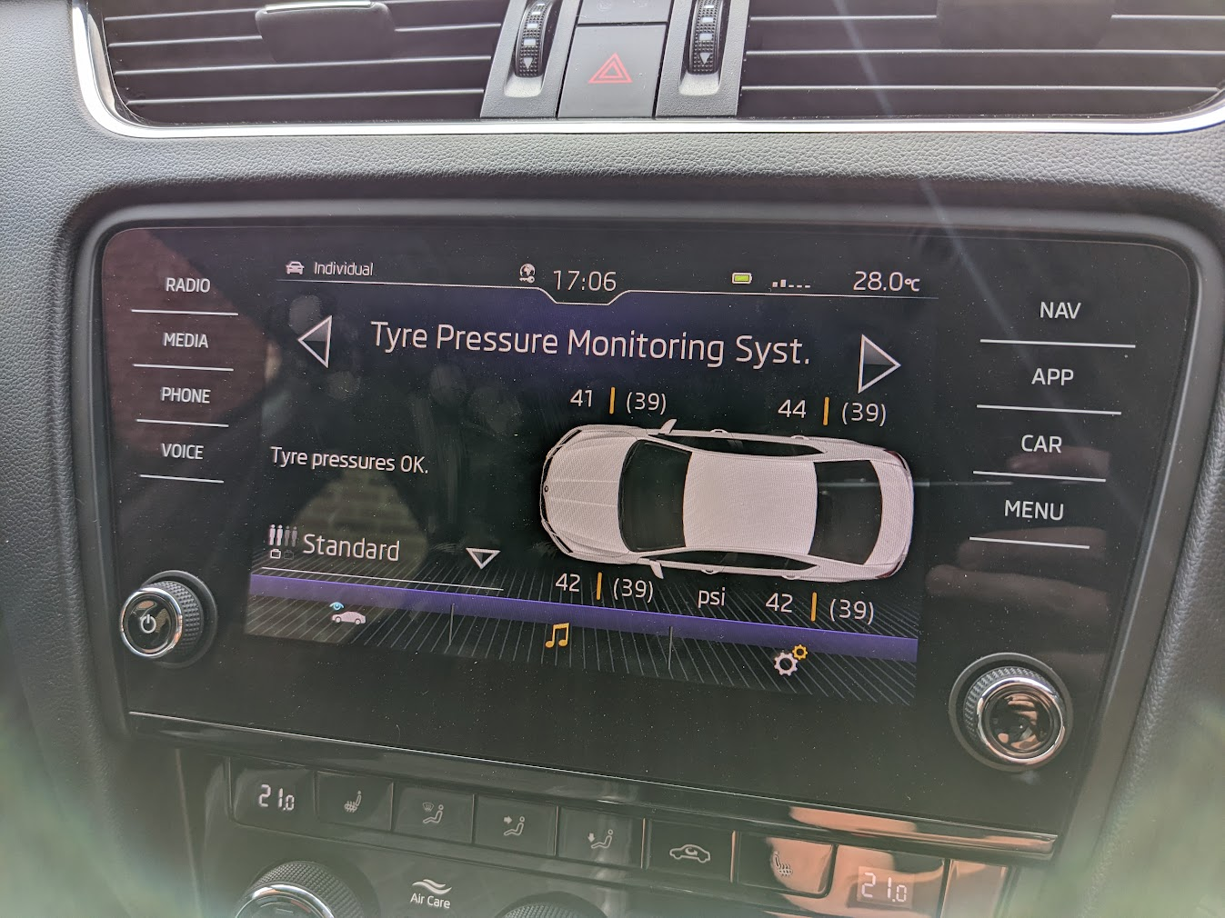

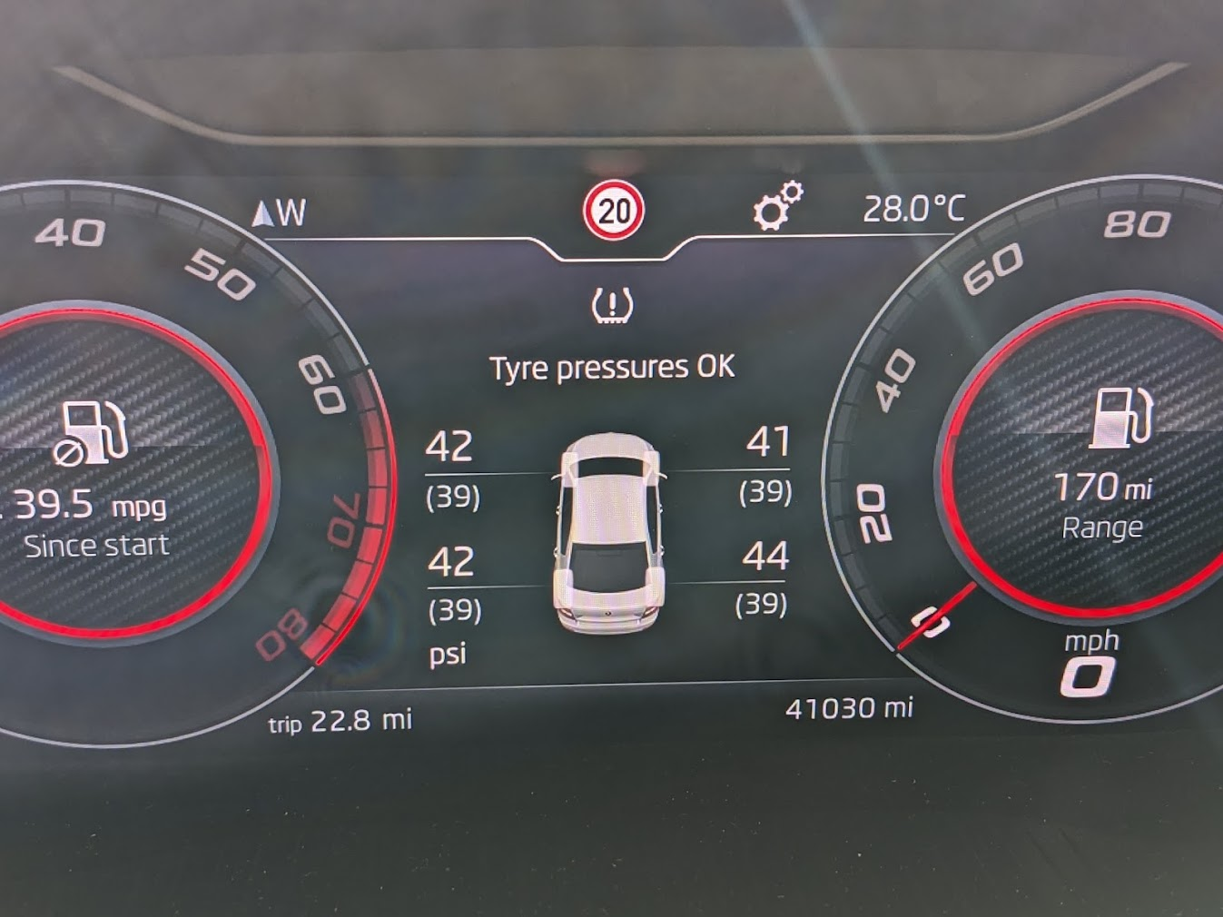

My TPMS retrofit on a MY18 Octavia works on both the headunit and virtual cluster at the same time...
