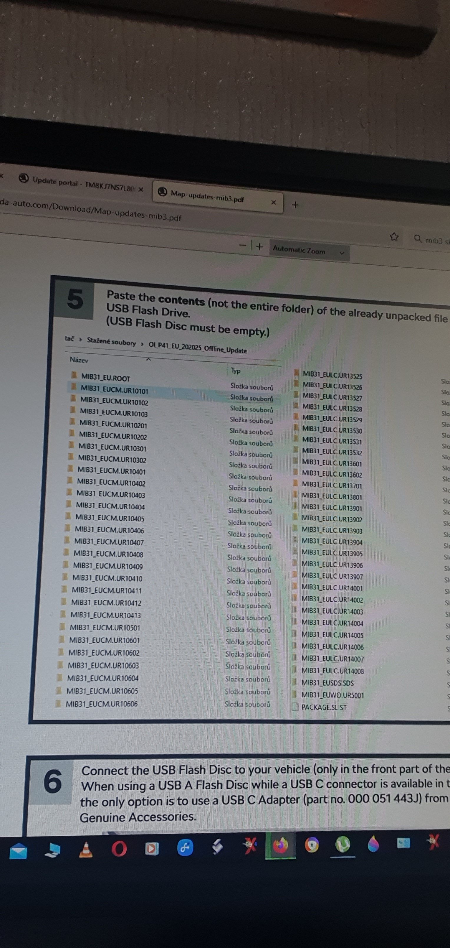

hi , I'm downloading the file again , I'm looking at the instructions , I'm confused by chapter 5 ? ..... sorry had to take photo on selfie mode ... normal was too big mb wise ... also I connected my car to my phones wiring and got the same error message .  cheers Tom..
You have 2019 Kodiaq with MIB2,5.
What you are trying to download is for MIB3, newer headunit.

hi , I've gone on the portal imputted my vin and that's the only file to download ... do you have a link at all to the correct one at all ? ...
Link seems to be correct.
Should be:
https://updateportal.skoda-auto.com/en-US/Updates/yourcarsvinnumberhere
I recall some 2019 had MIB 3 units, so might be correct.
Usually the procedure is like this - you first dowload the zip file. Then extract the file, it extracts into the folder with the same name as zip file is.
Then copy all the files from that folder to the root of the USB/SD. Dhould work, as long the memory thing is formatted to FAT32.

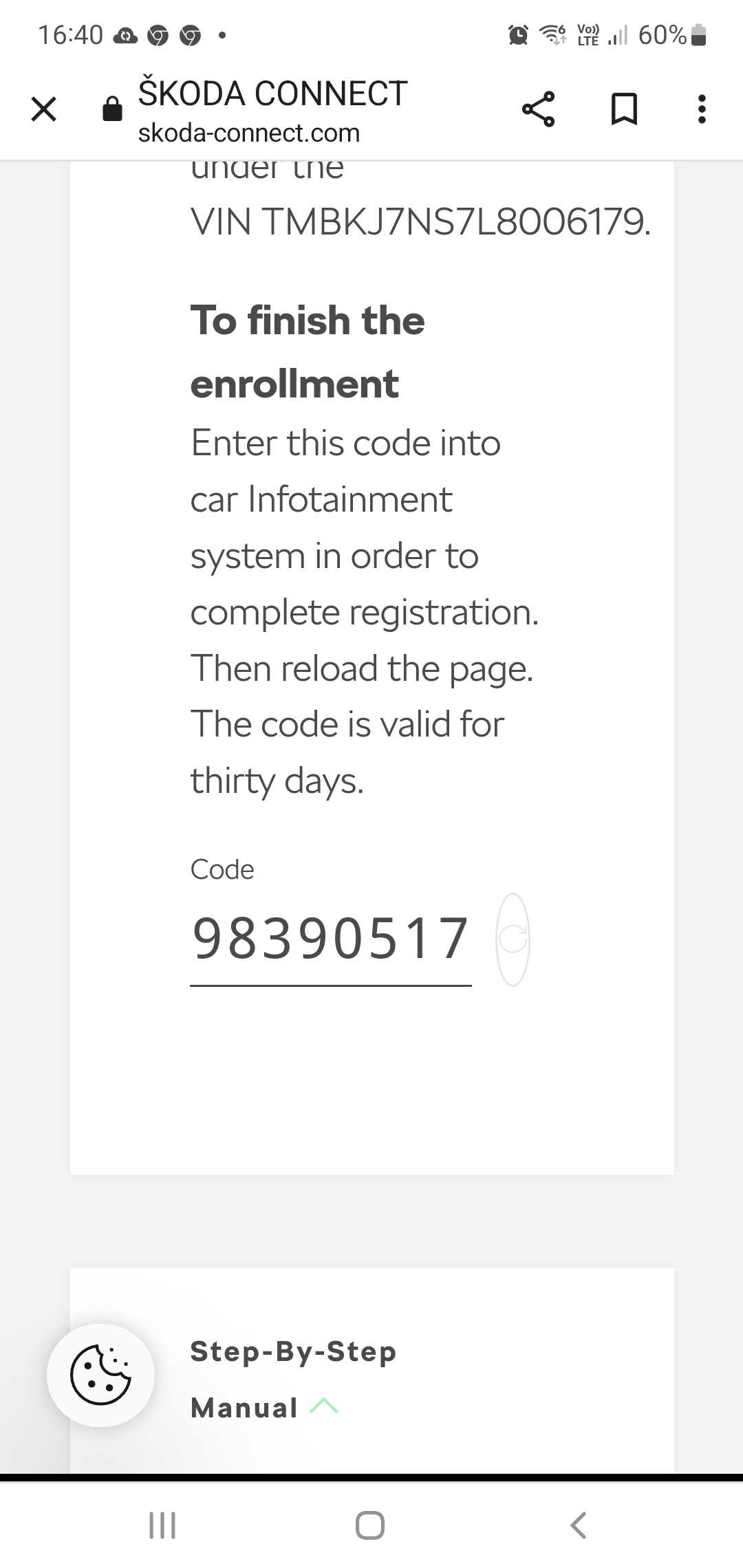

I used the exfat to format ..... worked a treat ... just notice my licence as elapsed and I cannot connect to the special features , I thought it would last at least a year , o ly had the car 9 months ... is it worth paying to access these features concerning the sat nav ? . think it's £44 for 2 years ...  plus I went onto the portal and I received this code , but I cannot find anywhere to imput the code ... any advice would greatly appreciated... tom..

MIB 3 is different than MIB 2. I don`t have to insert any codes on headunit.

i cannot seem to access anywhere in the infotainment settings to insert any blooming code .... plus when you use waze do you have to connect via a cable ? seems silly having to use a wire when using carplay ... tom

About code insert do not know, you have newer headunit.
