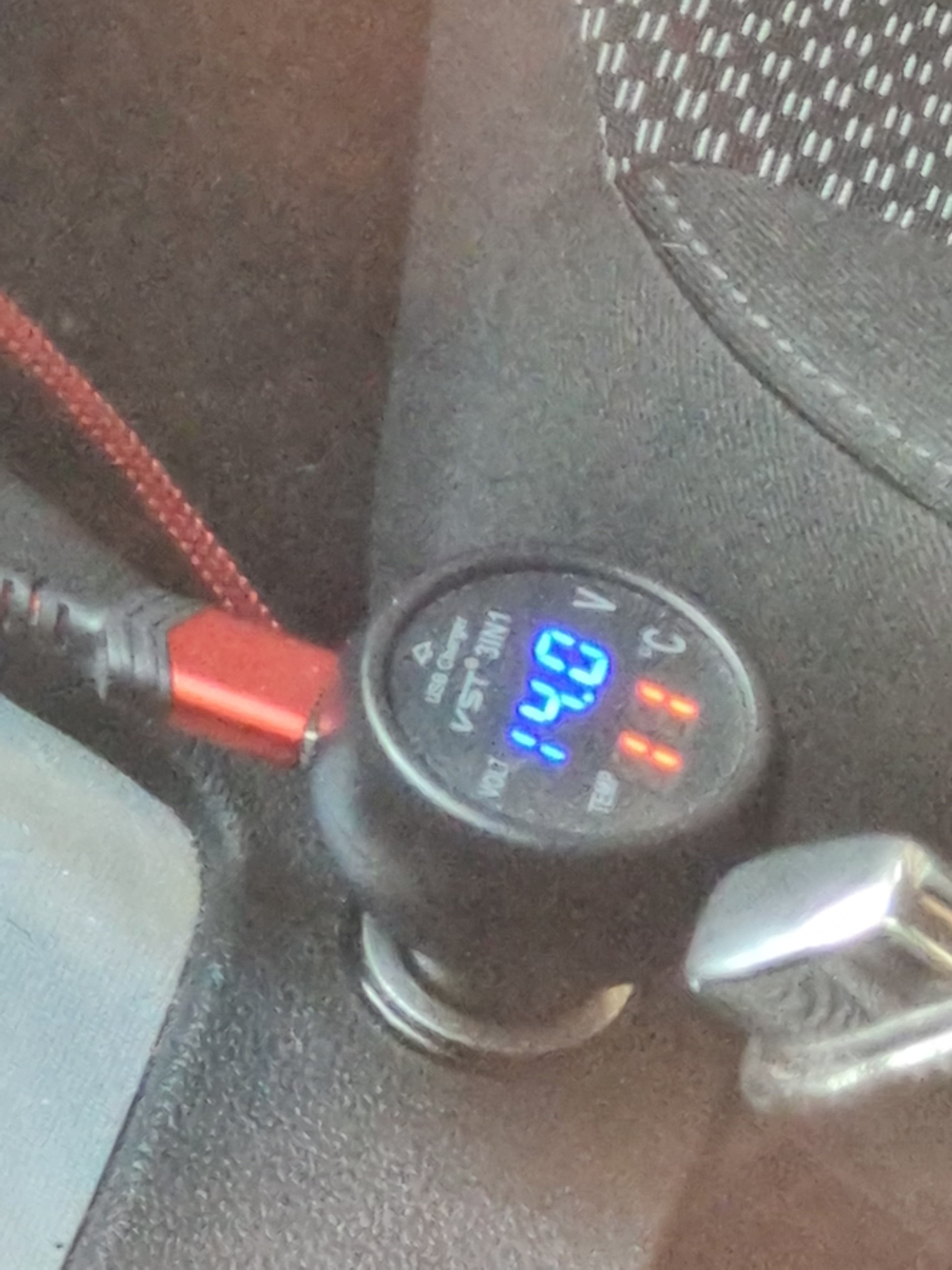

Thanks for your comments.The power socket in my Octavia is permanently live, so the Optimate  functions.  The  Skoda is way out of warranty. I did prod them about the faulty OE batteries at the time. The unlocked Kia's car alarm goes off when the bonnet is open and the battery charger is connected. That's why I use the jump pack on occasion.

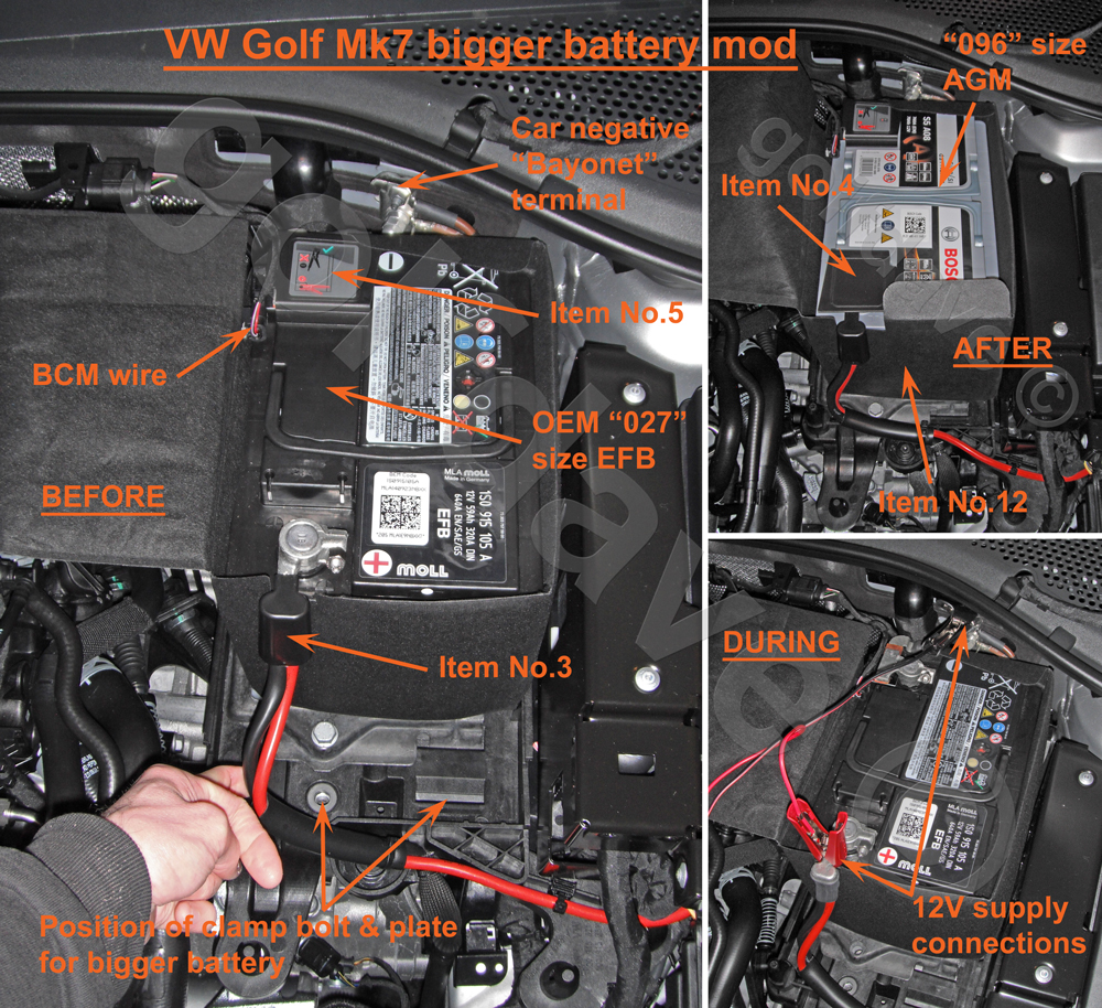

The MQB platform battery tray has 3 positions for the battery hold down bracket.....& VAG usually fit the size down from what the car ideally should have...
Ignore the Ah/rating on the Factory batteries as VAG use strange ratings on a standard battery case size designation.
I ripped out my factory mid sized Battery case size H5/027/Group 47, 59Ah/320A (DIN), EFB type battery & replaced it with the bigger case size H6/096/Group 48, 70Ah, 760A CCA (EN/SAE) AGM in January 2015yr....still going strong....I wrote a "how to guide" here...all info in first post:-
How to retro-fit a bigger capacity battery to a Mk7 Golf | GOLFMK7 - VW GTI MKVII Forum / VW Golf R Forum / VW Golf MKVII Forum
Mind you I have a Ctek charger that does normal & AGM types & also works as a 12V supply. There is usually gaps between the rubber seals on the bonnet & the top of the grill & the wires will go though that without being caught so you can close the car completely when charging.
When you swap the battery  you need to code the BCM as per my thread above:-

Photo from by above mentioned thread....bottom right...you always (for cars with stop/start) connect the positive "+" wire of the charger to the "+" on the battery....& then the negative "-" wire of the charger to the bayonet fitting "-" on the bulkhead...
Forget using the 12v sockets/cigarette lighter sockets on these cars with stop/start...

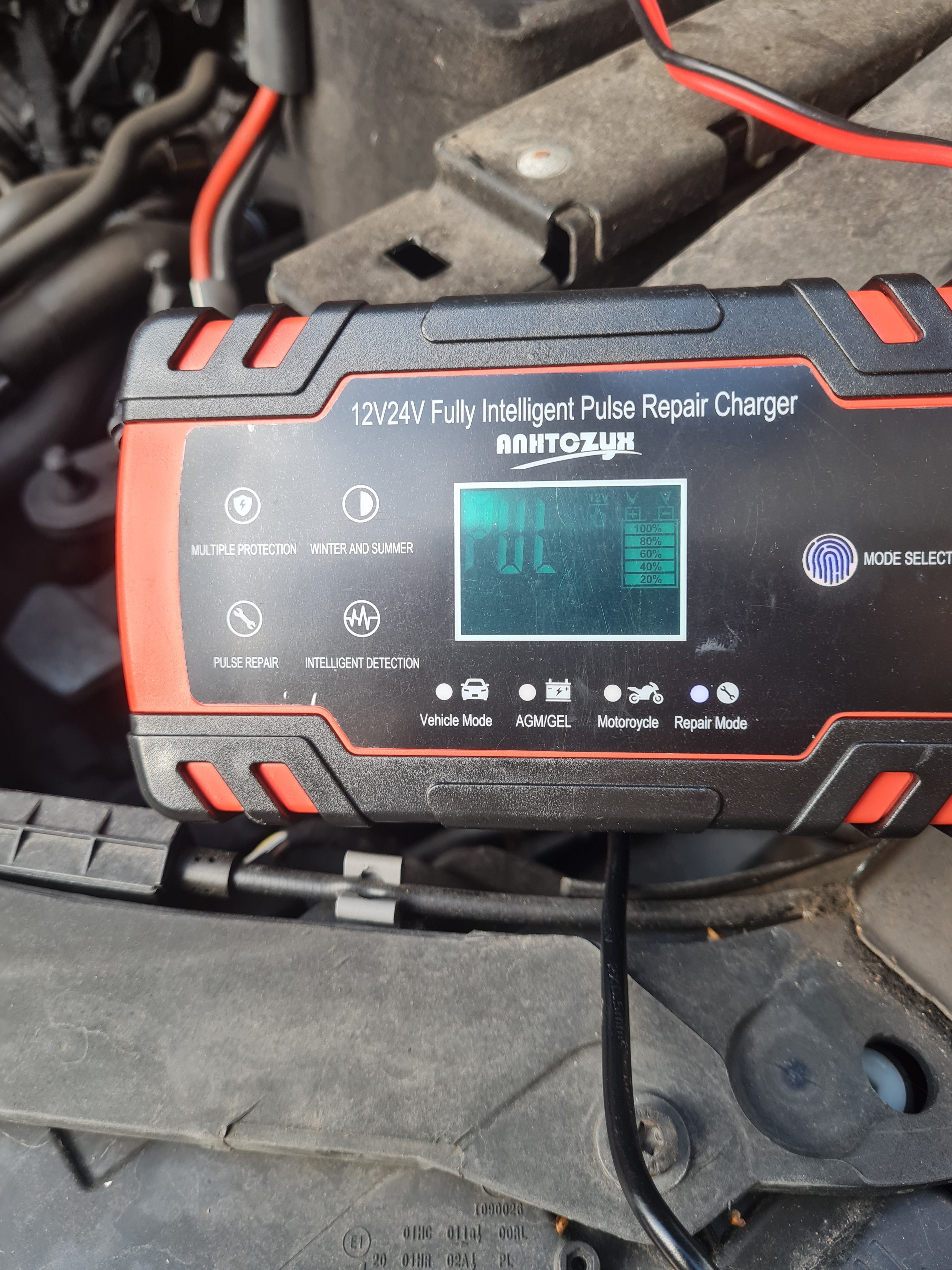

Personally I'd not use the Pulse Repair setting unless the battery was really low (at or beyond "death's door") and I've no idea how much the VW computer program would like it.  Up to you what you do but I would just have it on the normal 12v setting and let the charger do its stuff (connected as per charger manual and car's Owner's Manual).
Note the Owner's Manual has 0.1 or lower for charging so an 8-amp (or lower) charger for say a 79 (aH) capacity battery, going a bit over isn't the end of the world particularly with a "smart" charger and maintainer, going lower will take longer (but I believe is better) .
I personally prefer to go lower and charge for long as I've found over decades of charging my neighbour's car batteries, some of them "dead" (for a couple of years in the garage for one) that a very lower and very slow charge goes deeper and extends the battery's use and life longer.  Some (well one) disputes this but you can look up battery manufacturer's recommendations for yourself,  I put my decades of experience but perhaps I'm wrong and fooling myself as over that time I have failed to revive a couple of very "dead" batteries, one with buckled plates in one cell.
I've only once IIRC needed to recharge a battery on one of my cars - then my wife bought this VW product and things changed a bit and I bought (another) new "smart" charger (I already had a 20 year old 1.8-amp Optimate and 30 year old 4-amp Bradex chargers) as the car does lots of short journeys so I do a few preventative chargers with (too late on one as battery start/stop illuminated, I won't let that happen again.
Edited by nta16
I only used pulse for a short while. My first time using this battery charger. Switched off unplugged from the mains and plugged in again  and let it do it's thing. Switched automatically to OFF after an hour while the plug in voltmeter indicated 14V. The charging lead fits in the gap above the headlight.  Disconnected the unit as I've gone out; the indicated volts dropped to 12.5V. I'll keep an eye on things.
