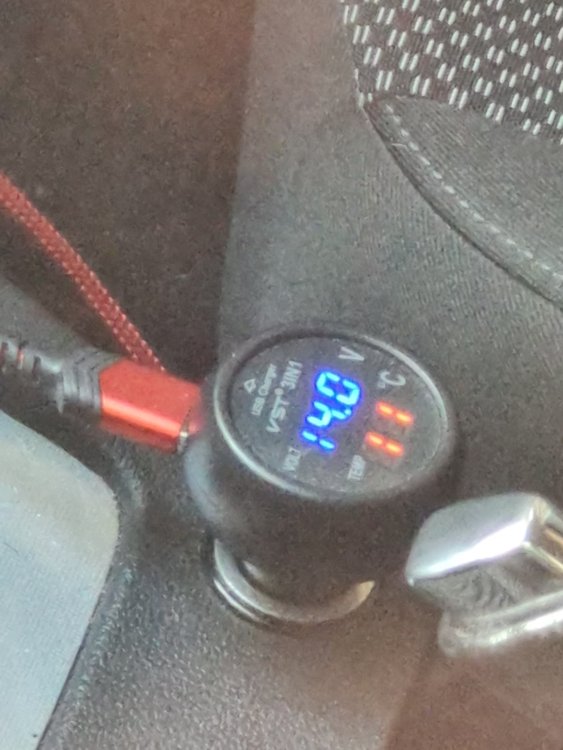

You can get cheap voltmeters that plug into the cigarette lighter socket, which should give you an indication of what the alternator is doing under various conditions.
Depending on what the BMS thinks the battery state of charge is the voltage at idle or when driving can be anywhere between about 12V and 14.5V
Yes, I already have one incorporating a USB outlet. That's how I know about the low voltage.

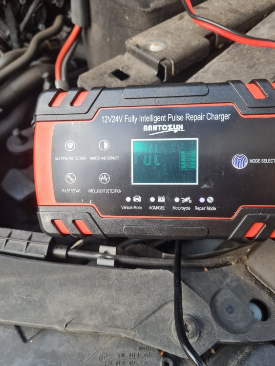

I already have the jump start pack. I bought a smart? charger a few years ago but using it on my wife's Kia just sets off the alarm. I used my Optimate battery maintainer on the Skoda via the power socket, but I note it's only intended for batteries up to 50Ah.
While not ideal, the lower capacity battery maintainer (charger?) will still keep the battery in better condition than without - it would only affect the length of time it takes to attain a full charge - and possibly any test function your Optimate maintainer has.
Re. why your using a smart charger was setting off your wife's Kia - could it have been because the alarm was sensing the hood was open while charging?
