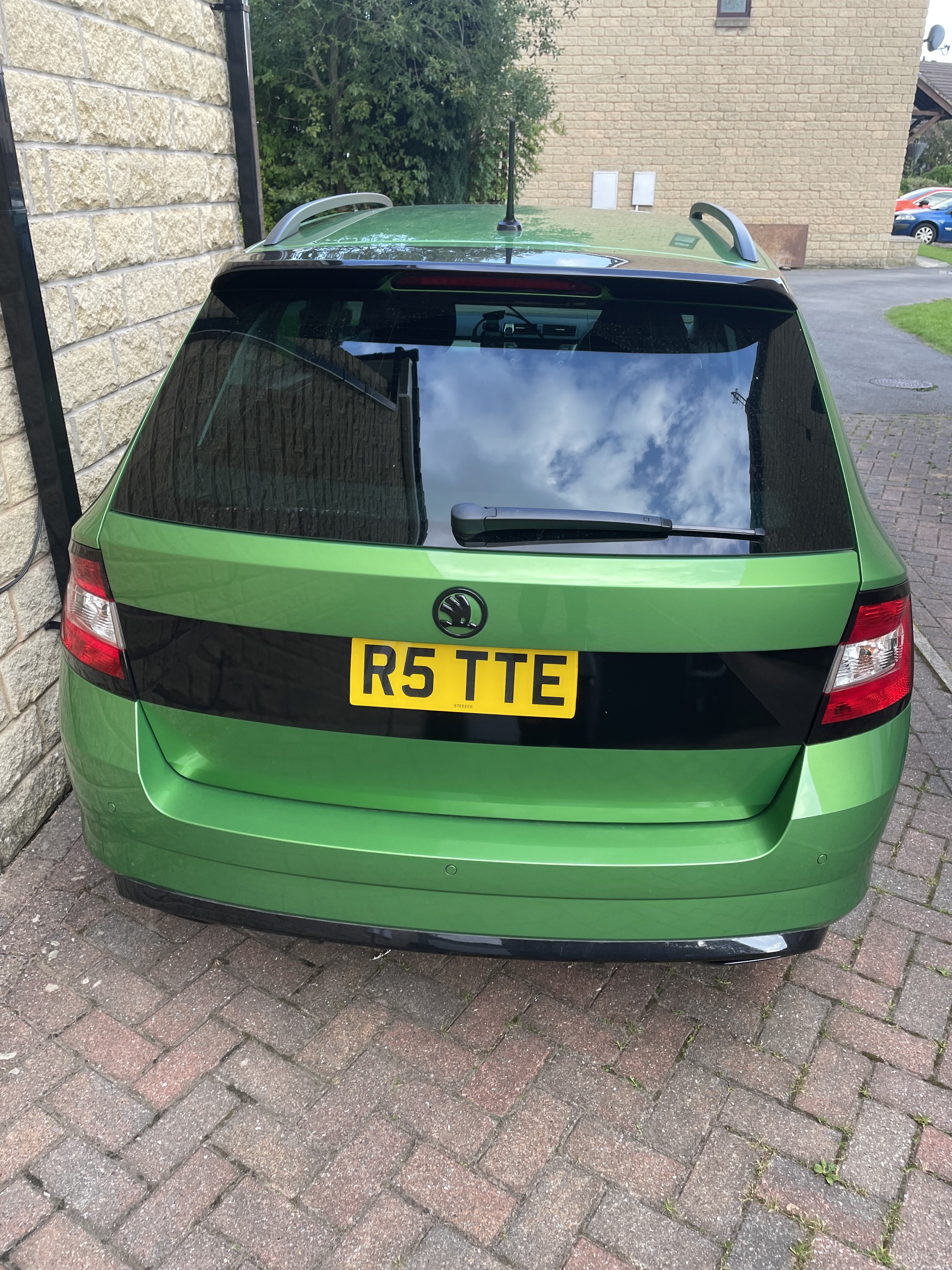

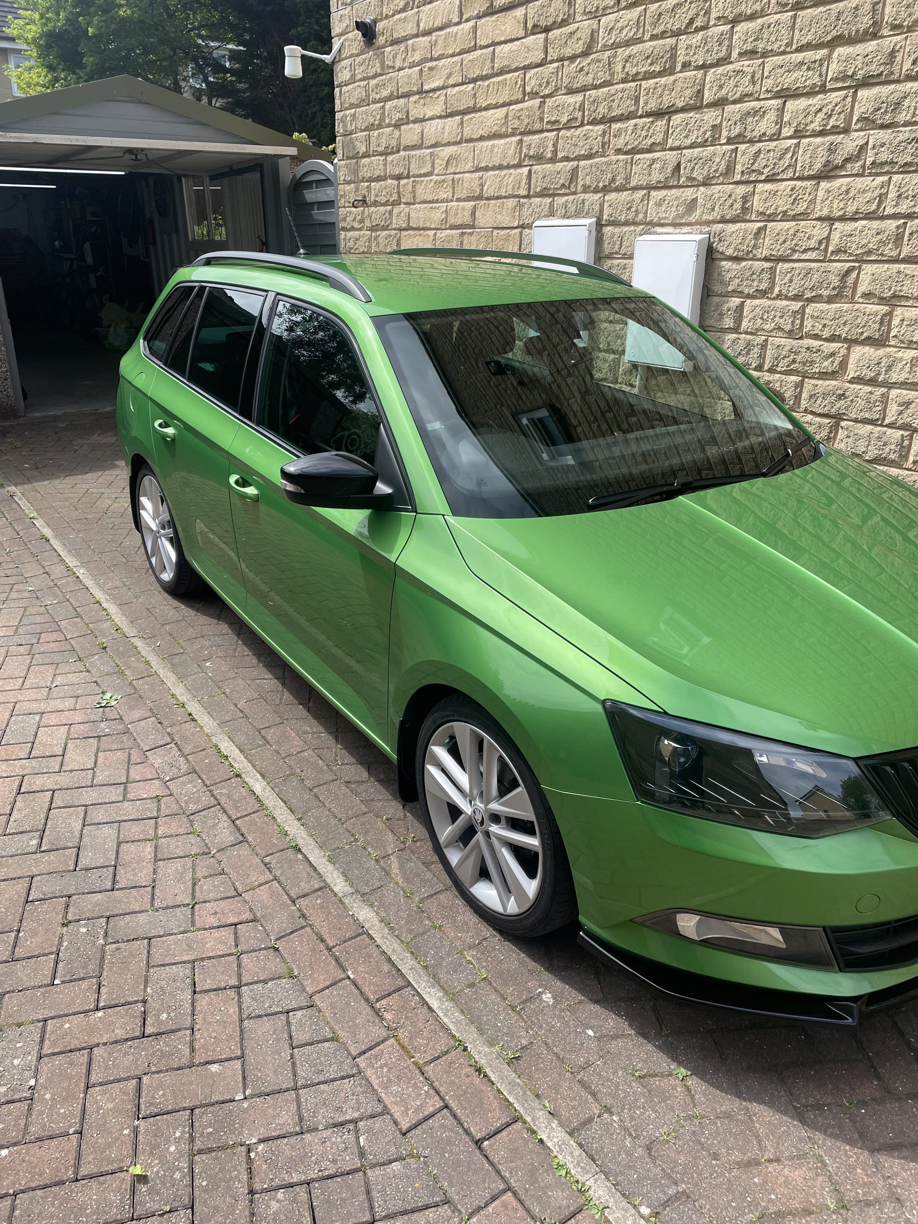

I’ve lowered mine 40mm on rear with springs and lowering dampers and coil overs on front 30mm, front splitter rear diffuser roof spoiler de badged, had a good spec from factory with sunset glass and 17” clubber alloys, also removed the center silencer remapped to around 140 hp had an mst induction kit fitted but removed it hot fed up with noise!
What springs do u use? And what was your method of debadging?
I started with direnza springs and standard dampers but found the front too hard so I bought some front coilovers and kept the rear direnza -40mm springs and bought some stance lowering shocks. Sits just how I want it handles spot on and decent ride quality.
as for de badging warmed them up with heat gun tar and glue remover on sticky left behind then buffed where they had been
