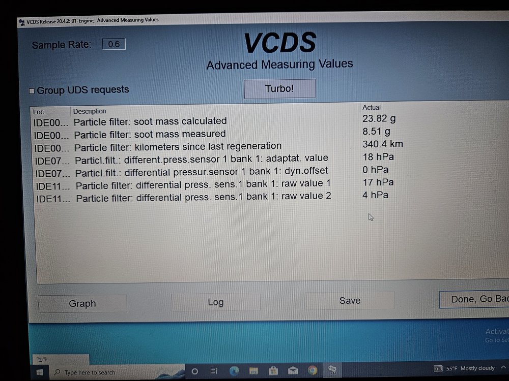

DPF values on VCDS (confused)
Hello friends!
Some help needed to understand the dpf values for my 2.0tdi 190
 Why 2 values 17 and 4 hPa ?
17hPa is at idle and at 2500rpm goes to 95 hPa wich I guess is a bit high.
Car runs fine,pulls great
