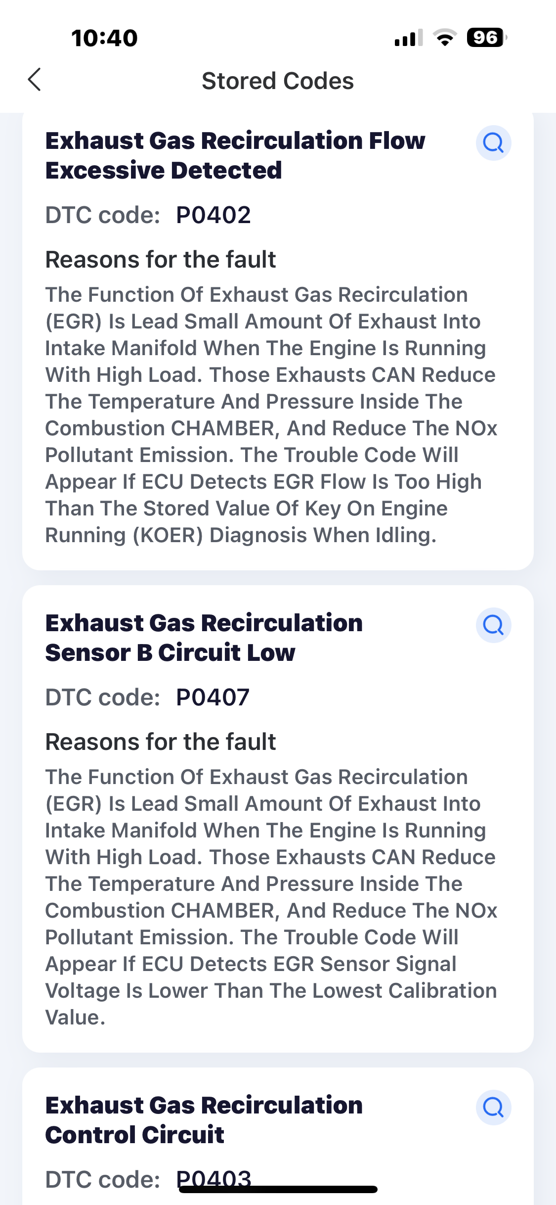

also now replaced egr valve as after the long run home the engine management light still came on..
I’ve got an obd reader and cleared fault  comes back on straight away with codes 402 403 407 all pointing to exhaust valve.. which I’ve replaced with a new one..
power steering light comes on occasionally then goes off again after restarting car… very intermittent.. I had found battery neg terminal was a bit loose but that hasn’t cleared it..

I’ll replace that I think I’m sure it’s not great.. hopefully that sorts power  steering .. but not sure about the exhaust valve issue unless that’s also battery drain?
What’s the sensor that comes from the EGR valve to the engine? Is that the DPE sensor?
can’t find what it is thought maybe that’s got something to do with the fault codes now?
Dunno, but "low voltage" can result in all sorts of errors which are cleared by a new battery and then clearing the fault codes.
I had the sprage clutch for the alternator on an Octavia 1 fail; fault codes generated included ABS sensor fails, radio and interior fan cancelled, issues with engine management and Climatronic... The cure was quite honestly just replacing the sprage clutch. So yes I find a suggested diagnosis of "duff battery" plausible.
