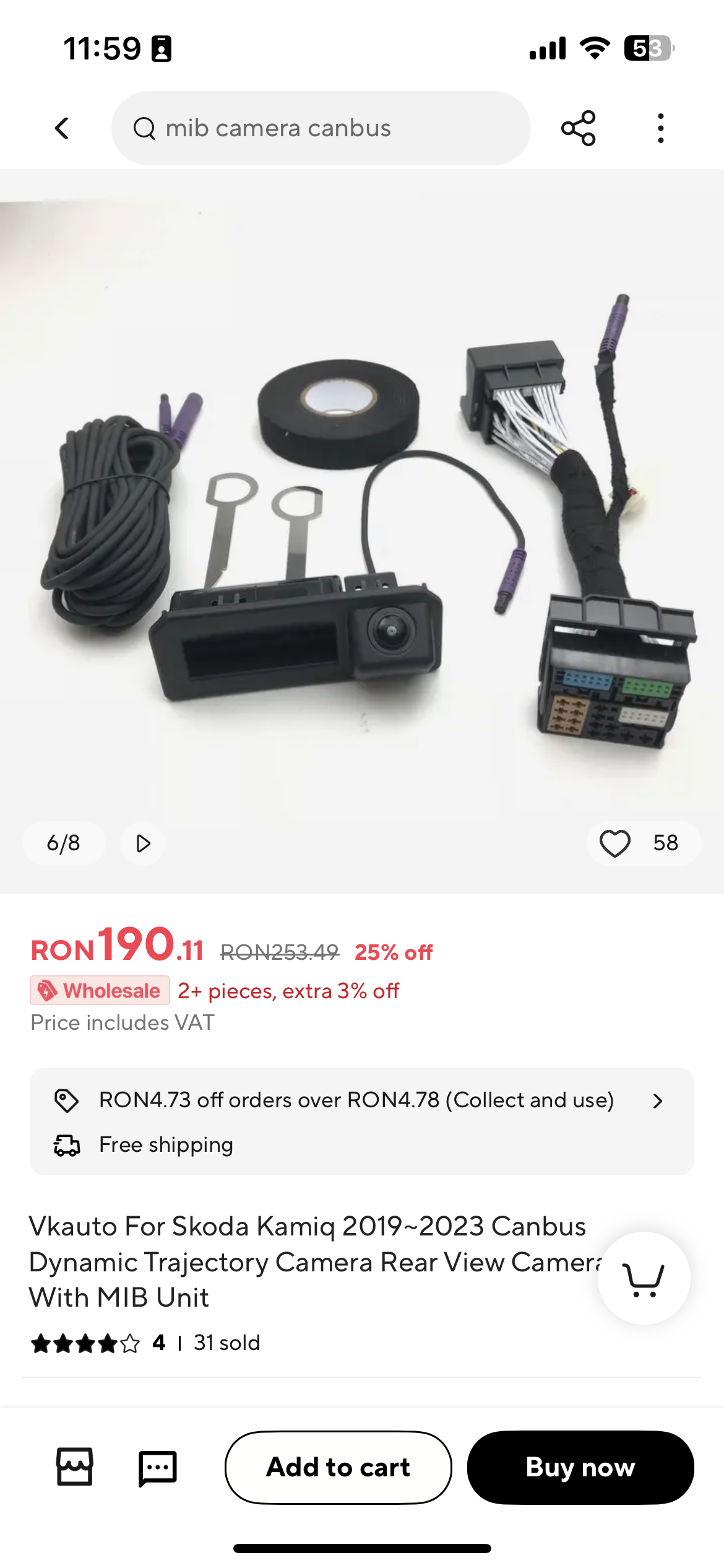

It’s a VKAuto for skoda kamiq
It looks like and does the same job as the Sinosmart cam but the price😮
They do have a free returns on your first order, just my opinion return and buy the Sinosmart cam, you want option CAM B.
don't look at the price, that's just a print screent, the price is 52 usd almost similar to Sinosmart.
i just spoke with the seller, he's looking for solutions.
Update: sometimes camera connect to infotainment and everything looks perfect, but just one time. Then 50 tries with no connection.
if i uninstall the camera same things happen with parking assist.
Any ideas?

Yeah, I do and sincerely i recomand you to install a genuine one. I had a lot of problems with the camera bought from ali. I messed up the infotainment, parking sensors.
Maybe i wasn’t lucky and chose the wrong camera.
I still have and i can give it to you for free, just to arrange the delivery from romania.
Keep in mind that the camera is MIB3 only.
