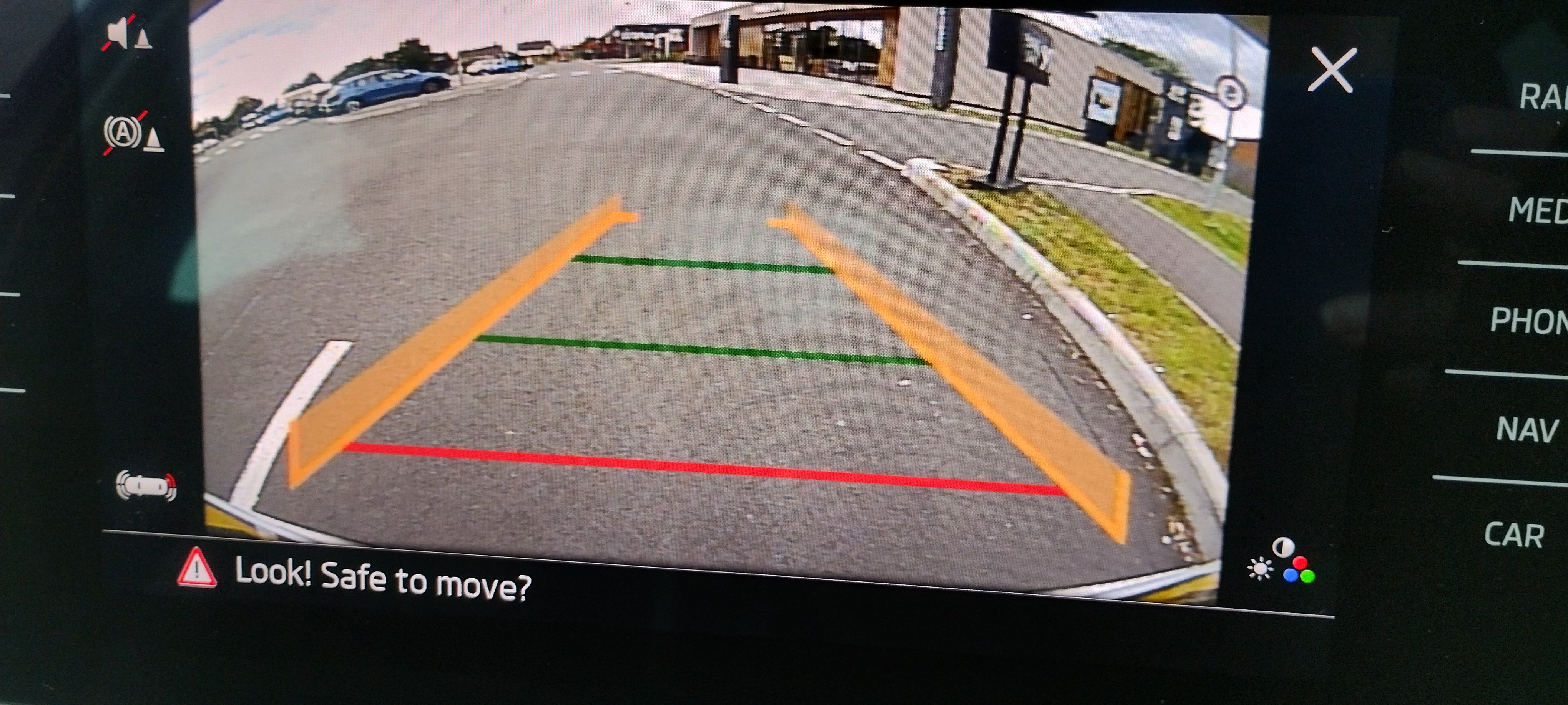

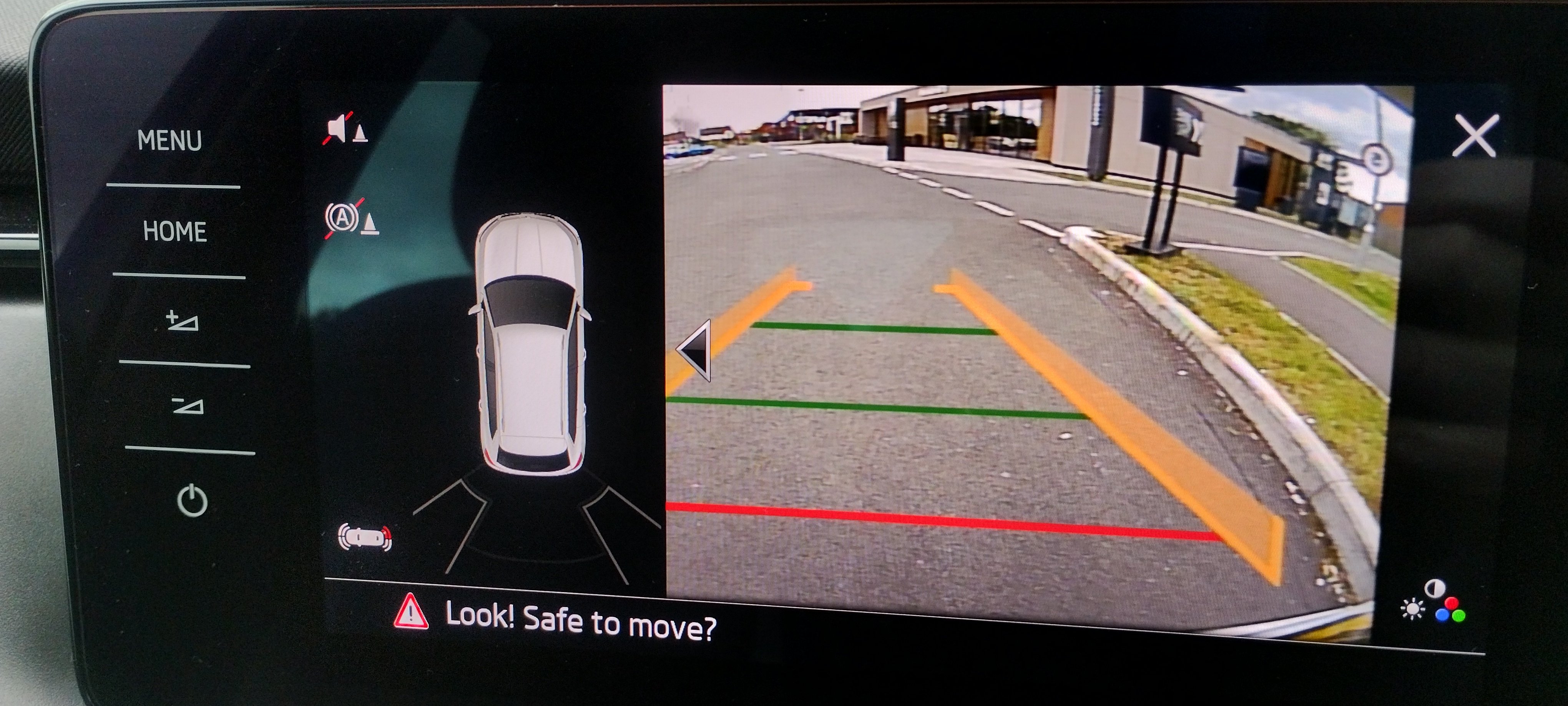

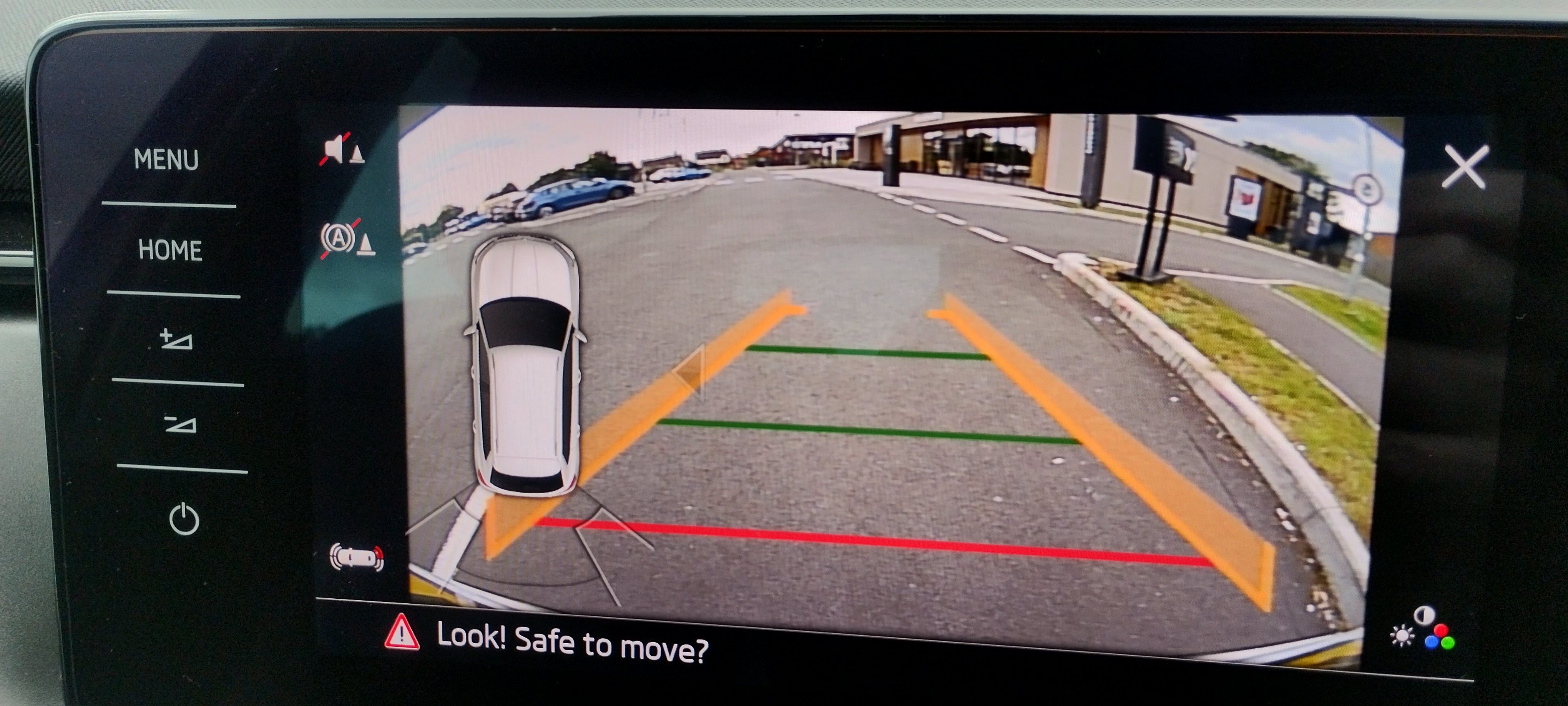

Camera now installed, decent quality and picture good, worth the money and effort in my opinion. Reverse sensors still operate with audible warning too. It's got adjustments for colour/brightness/contrast that's about it it shows the modes of display, see pics.
A little time consuming to install, taking the rear hatch panel off and routing the cable to the display but I've done this sort of thing before on another car, so expected.
Get a set of trim removal tools, makes it easier and protect the dash with a cloth/towel to rest the display unit whilst out.
Hope this helps others who are thinking about installing this particular camera, Sinosmart.
