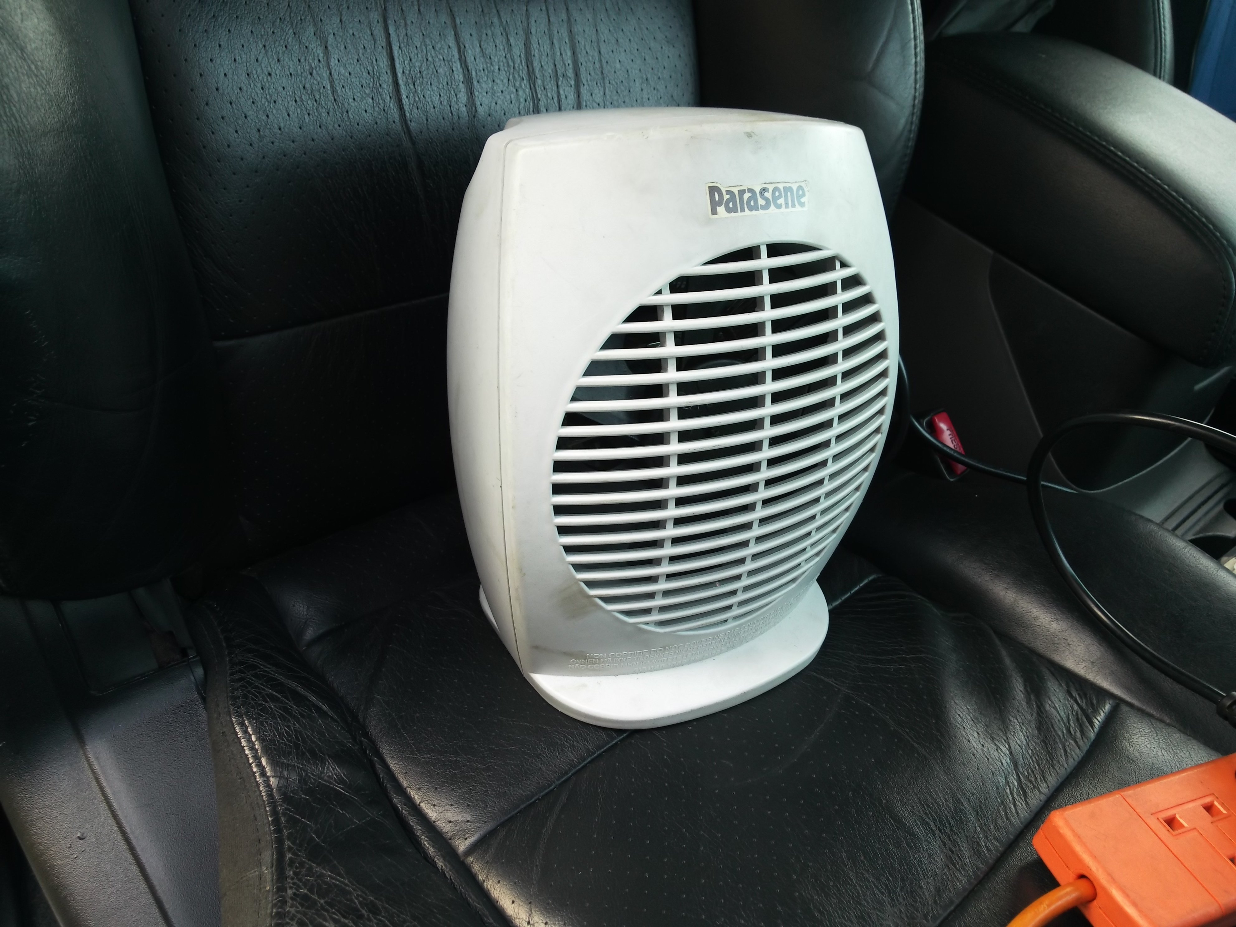

When you can be near home or a 3 pin socket / extension lead then a Green House heater is all that is needed.
DSCN3534.JPG.45cb5698af6ed19b5ccc6f23f94bf14e.JPG.c33f910e343e4b10043f32c53ba706d2.JPG.6e5e5d10ca88b5bf5be30379afc2ca58.JPG.dcb106d6eead5536daa3f742985e5c19.jpeg
DSCN4339.JPG.1597a7d34cbd994683a480bf945b374a.jpeg.f0f748bb61c39e3da4e3ba327c9be896.jpeg.a0a13ede7ce09fc1b981a09dc5d95bbc.jpeg
Edited by Rooted
That's how i defrost my car whilst having breakfast in the winter
Good for keeping mildew at bay and condensation all winter or all year in cars, campers, vans, caravans.
Set to above freezing and can use very little electricity firing up as when needed as long as there is some ventilation as well.
