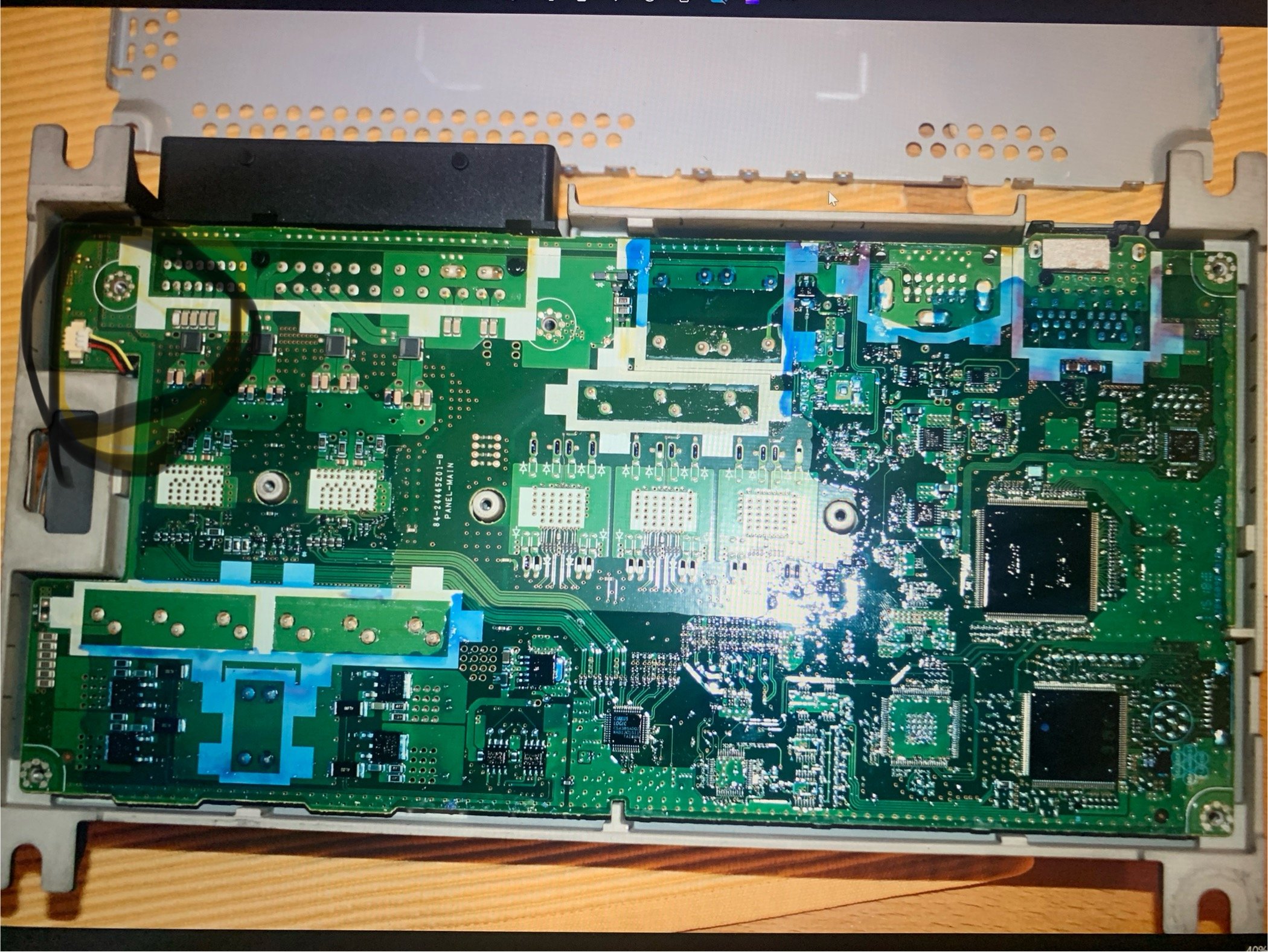

First photo on the left side , and second photo is other side motherboard .controlled fan put on 12 v from conector?
at least there is a schematic diagram of that motherboard!?
Edited by Picajzla
quite probably. I doubt *very* much you'll find a schematic. But what's the part? part of the issue is that you don't *know* it's the thermistor or sensor that's broken, that's just the symptom you see, that the fan no longer turns on. Could be a broken Chip no longer sending a signal, a broken transistor or mosfet no longer switching or a diode that conducts in both directions.
Honestly, if this is the only issue you have with it, I would try something like the externally temp controlled fan for a while and try to replace the amp in the near future when one runs across your path or it breaks (or both).
