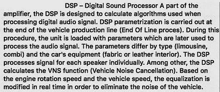

15 hours ago, Wacholek said:
I just wonder, is it a real DPS is in canton amp? Or is it just a digital amplifier connected to the head unit which is the true DSP? That might be true since the equalizer is the same in MIB3 even without Canton. I do remember that in my Octavia III I was able to switch the head-unit to canon even when I did not have one. Only deference was lack of sound but all other options was left untouched.
Speaking of Canton DSP.....
Canton is a DSP amp. Previously you switched only the output of the MIB to the internal amplifier or the DSP.
With MIB2 and 2,5 this should be still possible. Users on MIB3 cannot switch for some reason as the connection is via Ethernet
330633253_FromCantontechnicalmanual.jpg.18a097da26eec8b7dcd49fb622b3b649.jpg.2c3aab7e6ffe2a1469859faab62845c0.jpg
this makes sense. My A2 gets a reindeer fur cover in the sunroof each winter and it changes the sound signature in the car significantly if it's there or no. If this works out with the car change, I'll maybe try to do some white noise tests at speed (with a passenger) to get some hard datapoints. But just turning the audio off should indicate if some active NC is being used, maybe. Or pulling a fuse.
Reindeer fur?? LOL
Fur sure it changes the sound. Reflections  and dampening. Nothing to do with noise cancelling. The sound ingeneer who designed the accoustic Canton setup in the Superb is a good friend of mine. He would know if there was any NC.
yep, it gets cold up here..
the concept of "noise cancellation", even "active noise cancellation" does bring a couple of interesting questions. First is the big one: what could that actually mean?
So, thinking about it, an "active noise cancellation" could just mean that the base noise of the car - has been recorded, inverted, and used with the speed compensation (for example) to change the noise profile that's being reproduced, to actively cancel - but without using a mic array to analyze in real time, just using a couple of standard profiles to improve NVH.
Truly active NC would be with a mic in the car (for example the mobile phone one) and actively inverting this and inserting it into the signal chain, rather than having this defined one time.

You cannot do NC on random noise even with mics. It would work only in ear/Headphones where the inverted signal can be produced in time when the noise is passing the sound actuator. In a car you'd like to foresee the noise, as the inverted  signal has also the traveltime to our ears so it is for predictable noise like engine sound.
If you read the article, every car there has quite the same:
"Of course, another strong contributor to a quiet cabin is the Active Noise Control. It generates noise-canceling sound from four door speakers and the subwoofer to reduce unpleasant engine harmonics."
