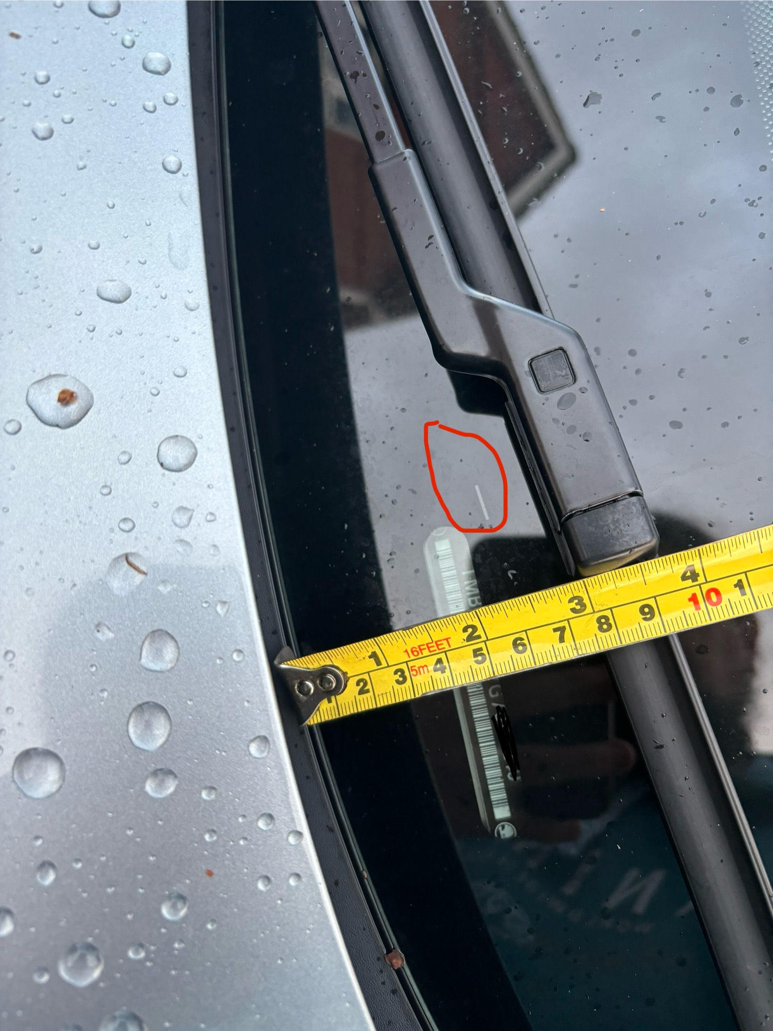

Hello, not too long ago I had my windscreen replaced and it’s evident my passenger wiper arm isn’t in exactly the same position as it was.
When I’m driving and got auto wipers on and it returns to the ready position (but not full seated like it’s turned off) I can see the blade against the windscreen and is annoying
I I looked at Elsawin and it’s really not clear on where it should be 😞
Can someone pleasure measure the distance between their wiper blade and the top of the plastic scuttle please?
Here’s a picture of mine, Elsawin said something about +-4mm and might be talking about the bit I’ve circled in red but not sureIMG_0149.thumb.jpeg.d5a14e1a6208d39921f03e57987c08e2.jpeg
thanks

What I meant by the ready position is it parks up higher than where it does when the cars off
Kind of like when the cars off it sits in position A, when it’s raining and then stops the wiper arm sits in position B, turn the car off and it goes from position B to A
I think it’s out a few splines but as it’s usually a pain to remove it would be good to only do it the once

Does yours sit that high as in normally 3” gap when off? If so then it must be correct but can’t help but think I would have seen the wiper blade as much as I do now in the last 4 years or so

Danoid, to put your mind at rest, my wiper is sitting 3.5 to 4 inches above the scuttle while parked, even higher than yours.
however the darkened shaded part of the (original) lower screen extends 5 - 6 inches up from the base so still hides the wiper from inside when parked up.
dont think your blade is parking any higher than it should, but, maybe, the darkened portion of the lower new windscreen doesnt extend as far up so your wiper is visible??

Thanks for checking, I did insist with AutoGlass that a genuine screen must go in which eventually did after two people turning up with non genuine.
I guess it’s always been like that, just one of those things once seen cannot be unseen 😮
