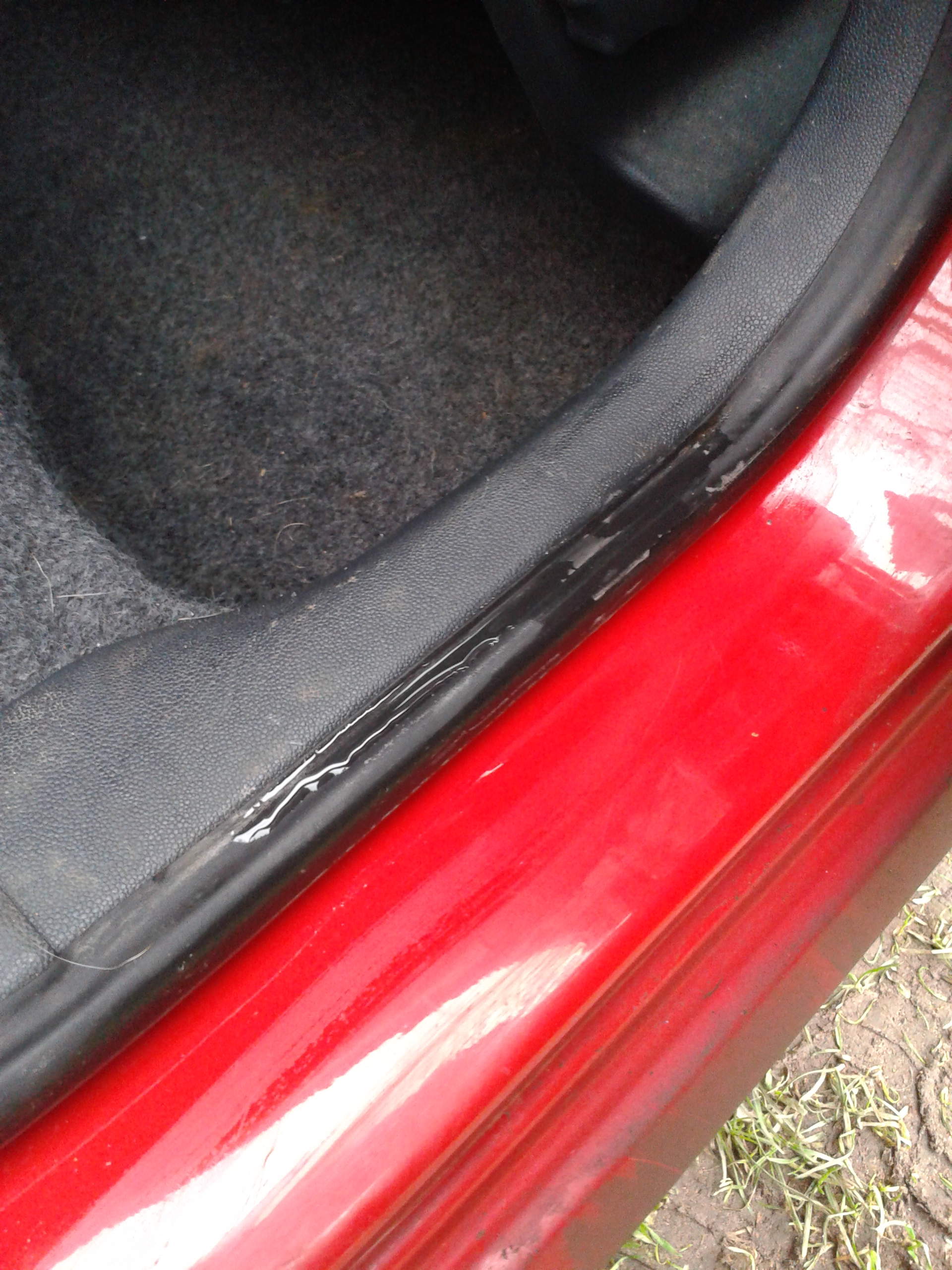

Water on the rubber seals at the bottom of the doorway is a giveaway that that door carrier is leaking:
