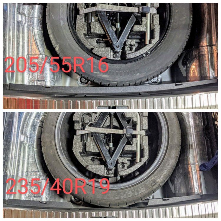

On 10/01/2024 at 22:20, JR RS said:
My Superb came with a 16" spare tyre as standard - 205/55/16.
I've since bought a 5th 19" wheel (to match those on the car) and use that as a spare.
The boot floor sits up an extra 20-25mm or so, but that was resolved by putting a thick foam around the edges, above the sound deadening material.

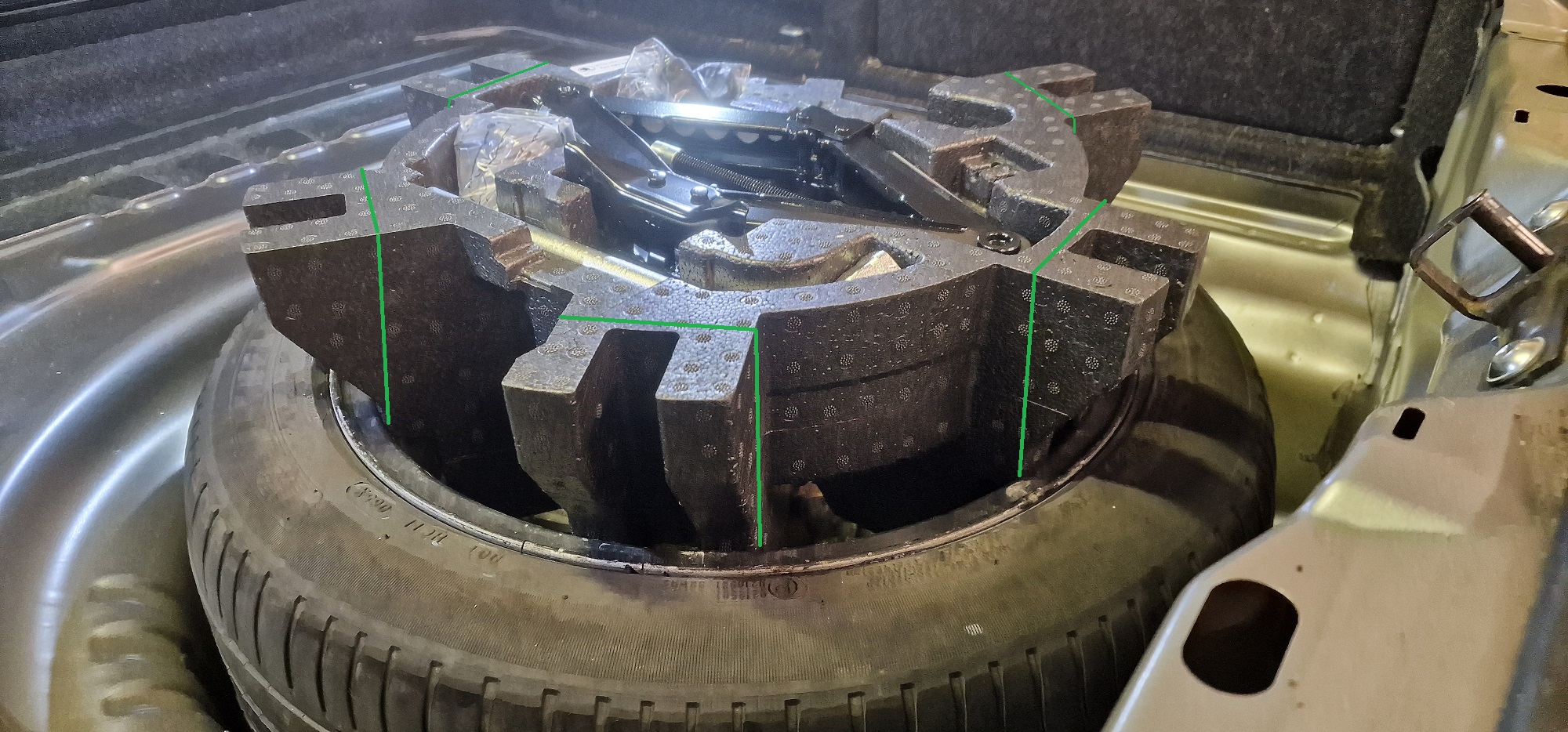

Hi I am looking at maybe going for full size 19" spare. Do you have the details of the spare wheel kit in your picture?
Thanks
Thanks
Sorry, I don't have the part number, though @Carlston might.
Mine came from factory with the 16" spare and the kit.
So I simply swapped out the 16" spare with a 19" spare.
The 18" spare kit from the factory comes with a different version of the kit - thinner and wider.

2 hours ago, bpren said:
Thanks - so do you think th 16" kit would work best with 19" vega wheel as spare? Aluminium Rim 19" VEGA Škoda 3V0071499GHA7 (skoda-parts.com)
i'm currently using it with the 19" Trinity wheel - no issues, provided u use the strap to hold it down to the rim.

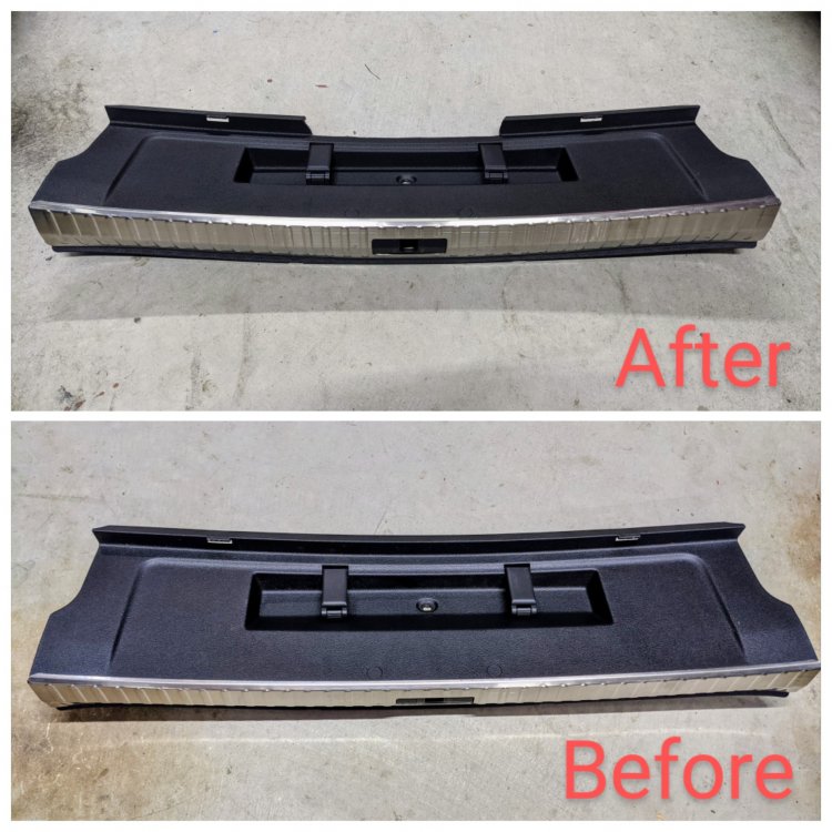

On 12/01/2024 at 22:34, JR RS said:
It's a small cut out of the plastic trim - easy to do.
There is enough room in the wheel well to fit a 19" wheel.
Is it ok to make this cut with the trim in place? I would prefer not to have the extra effort of removing and reinserting the trim? thanks
Yeah, should b possible to do the cut without removing the trim piece.
Thanks very much everyone - got the full size spare sorted now with the cut to the plastic trim. Appreciate the advice available on this site.
