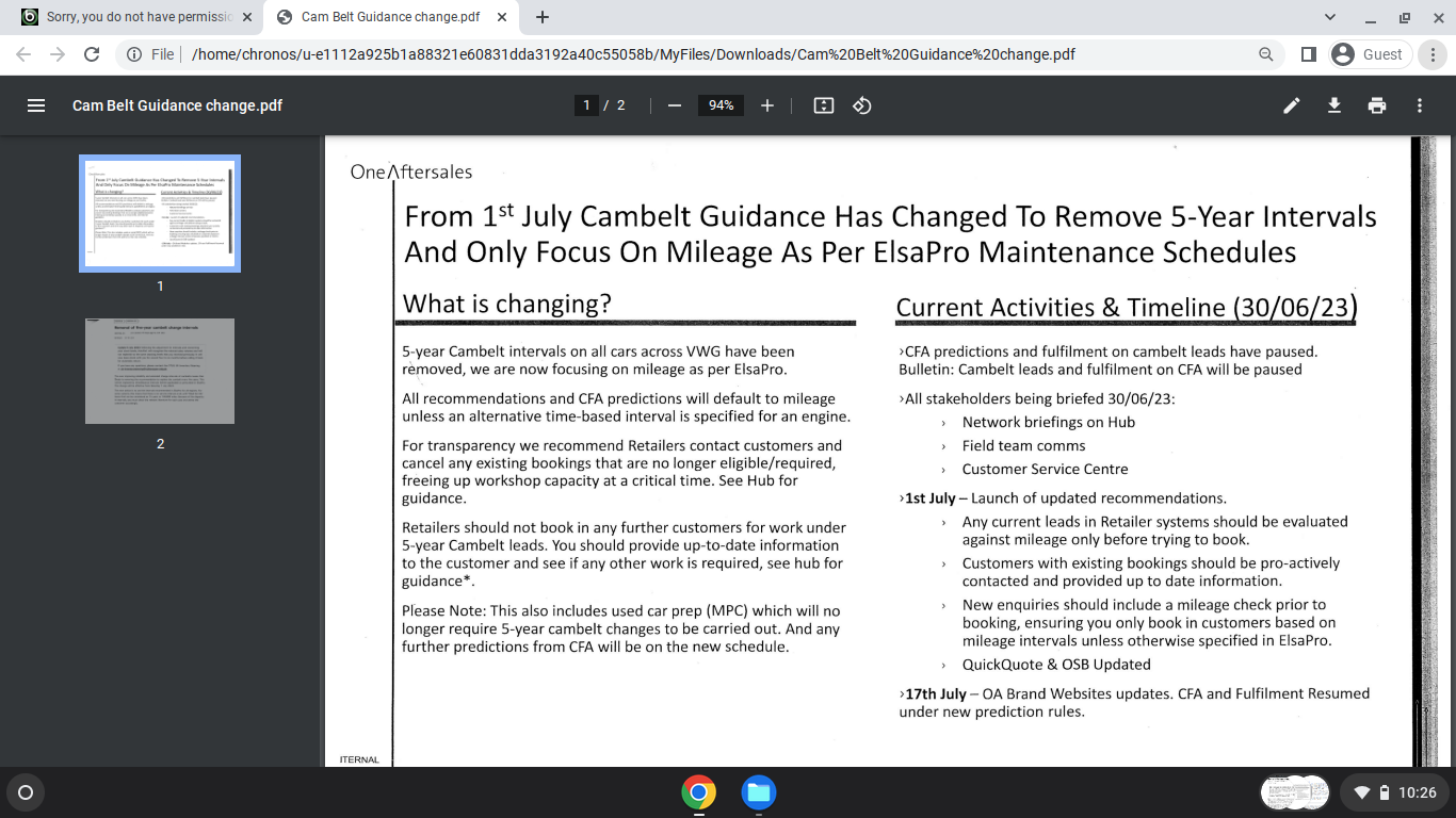

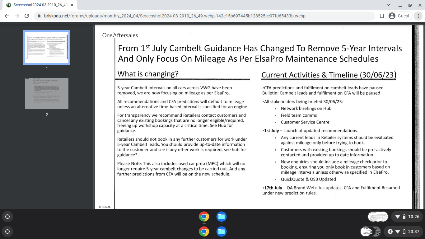

My Skoda Dealer has just informed me  "Skoda used to recommend the timing belt was replaced on cars at 5 years , since June last year they changed their policy and it is now due at 140k miles only. Some customers still like to get it replaced at the 5 year period but it is entirely up to your own preference."
This seems to be in line with what VW and other parts of the VAG group recommend.
I seem to remember a few years ago the time/milage interval varied from region to region looks like they have standarised now.
  • Confused 1
I called Skoda today to book my 1.5 DSG in for its 5-year service, and they also informed me that it’s now recommended to change it after 140K miles. It was a very pleasant surprise, considering it’s only done a very low mileage
  • Confused 1
