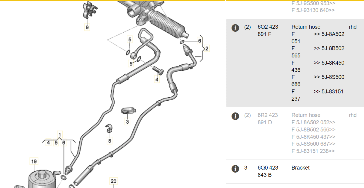

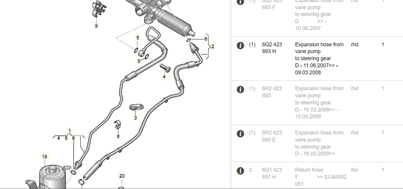

Neither hose available from Skoda any more. Genuine prices before they were dropped were amazing: £273 + VAT and £181 + VAT.
Watch out for aftermarket ones with claimed equivalence to similar part numbers on ebay etc, but with 6Q1 instead of 6Q2 at the start, they are for LHD set-ups and presumably won't fit.
Not sure if the 6R2...part numbers shown below each of these and applicable to later built cars can be made to work on your set-up, but they're not shown as supersessions for your hoses.

Thanks for that.
Can you tell me looking from the front of the car do the pipes connect to the left (driver side) or the right of the steering box.
I thought I traced them to the left but you pic looks as if they may go to the right.
Thanks
Ps where did you get your parts diagram from?
Don't know, look for google images corresponding to those exact part numbers and compare with what you see in the car. Diagrams are often a bit generic on ETKA.
Those data are from partslink24, a subscription site.
Approximately the same info can be found here, minus the VIN filtering: Car Parts Catalog - LLLParts
