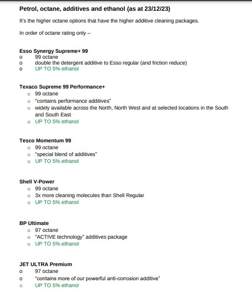

Were are you?  98 (Min) E5 would be right and depending where you are it might be Winter Spec now and 100 / 100+ octane.
In the UK there is no 98 Super Unleaded, it is 97 or 99 Minimum E5.

This was posted by @nta16 concerning the UK, he is a good source for stuff like this.

Petrol - you can research for yourself the difference in octane but also note in the UK at least the higher octane petrols also have higher additive packages, mainly cleaners and the cleaner the engine runs the better generally, another reason for good air filtering, think of the engine as a giant air pump and all the stuff that is in the air (like fumes and bits of rubber oversized wheels and tyres on all modern cars).

BTW thanks for the compliment about the petrol list but I just copied off someone else and updated it, I no longer need to worry about such things or inform others about ethanol-free, or can put it in my neighbour's cheap Chinese mower engine so I'm well out of the loop as they say, and you gave me a load of info on this anyway (thanks).
