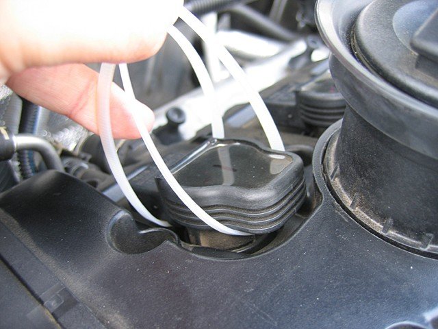

When someplace without the tool i use a Welding rod and pliers and make a tool.
Some do it properly and it is just like the real McCoy,  and some do the Zip-tie thing.
5b1b9a73bf17f_post-86161-0-08308400-1458043180(1).jpg.97fac8cae9dc5b87c0ea90314dda9c31.jpg
