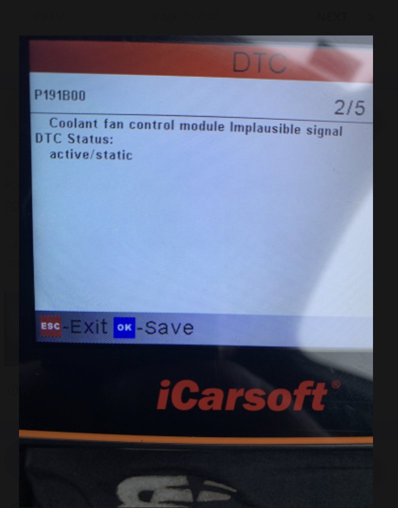

I’ve only on fan, so just tying to work out if there something wrong with it as that code came up when I scanning tool
