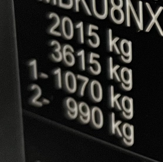

Hi All
got my new car today.
no factory towbar prep
Please see photo of weights.
as I understand it the 2nd weight is a total car + trailer. Right?
41 minutes ago, jimcallaghan said:
Hi All
Yes you are correct, so means you can tow 2015Kgs
1600kg
Car 2015kg. Car can tow 1600kg totalling 3615 as I read it.
