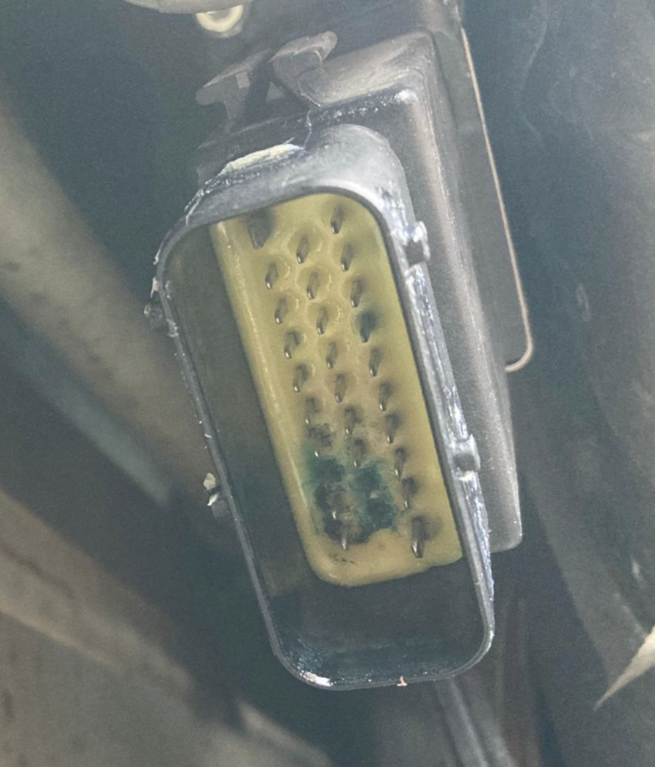

c/ Inside all 4 door shells you will see a multi-plug for the harness
d/ Unplug the two halves and inspect for any contact corrosion.
e/ If they look ok give both halves a good squirt of contact cleaner and re-connect.
f/ Finally carefully wrap the connector block in a plastic sheet using ty-wraps, paying special attention to get a good seal around the cable harness, this is where the water gets in.
NB: What happens is water / condensation runs down the cable harness and collects in the multi-plug (these are not water proof) and causes corrosion on the contacts.
Some owners have even found that on or more connector pins have completely rotted away. (Replacement pins/sockets are commercially available).

this is what "Silver Bullet" was mentioning  (driver door electric motor connector , gets the signals for the lock and other stuff and then it reroute them on the door )
