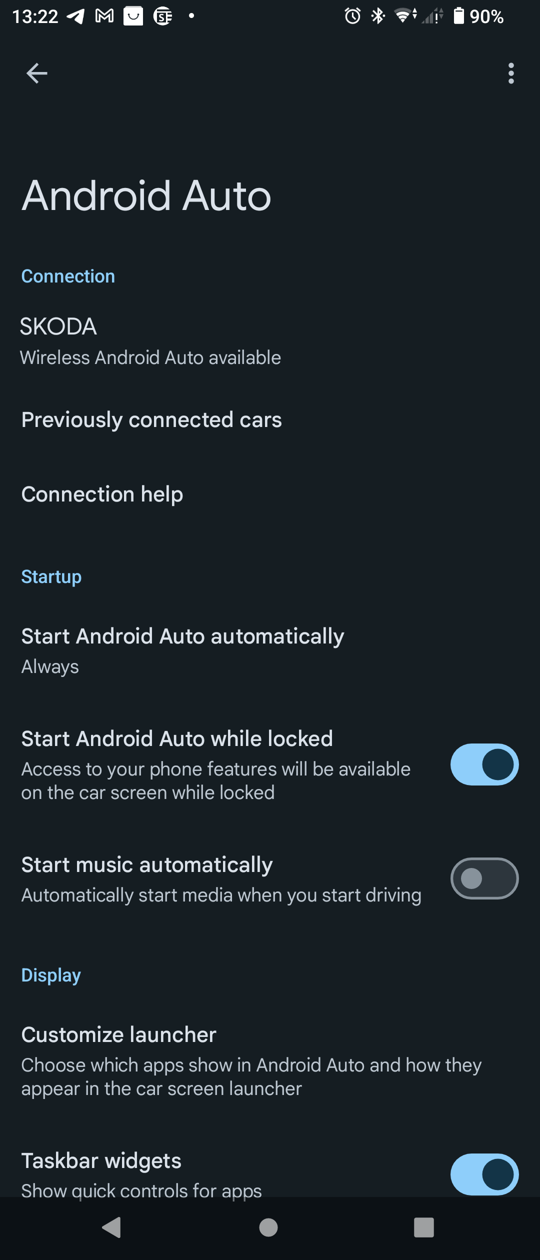

I also bought a second hand Skoda with exactly same versions like on the picture in the post above. My main issue that my mobile can't connect wireless, even that phone recognize the car and see that can be connected to android auto wireless. Will the update fix this issue?

9 hours ago, dima_vy said:
Hi guys!
Hi,
You don’t mention if your mobile is Android or iOS.
Early versions didn’t support wireless AndroidAuto, later one do.
iOS should work wirelessly with older infotainment versions.

You right! I use Android device, Sony Xperia 5iii. It looks in Android Auto app that wireless should work. It also worked for me with another car i rented abroad (VW T-roc 2023)
I had a similar issue at first too.
I found that after I'd initially connected to the car with a USB cable and started using Android Auto with a wired connection, it would automatically connect wirelessly after that.
It's not the way it should work, or how the on screen instructions tell you to set it up...but it worked for me twice! (I did a system reset and had to do it all over again)
I tried to connect it with USB, and it worked just until I removed the cable. Once cable removed, android auto icon near the phone name in mobile devices becomes grey and the car doesn't recognize the phone as android auto device any more😕

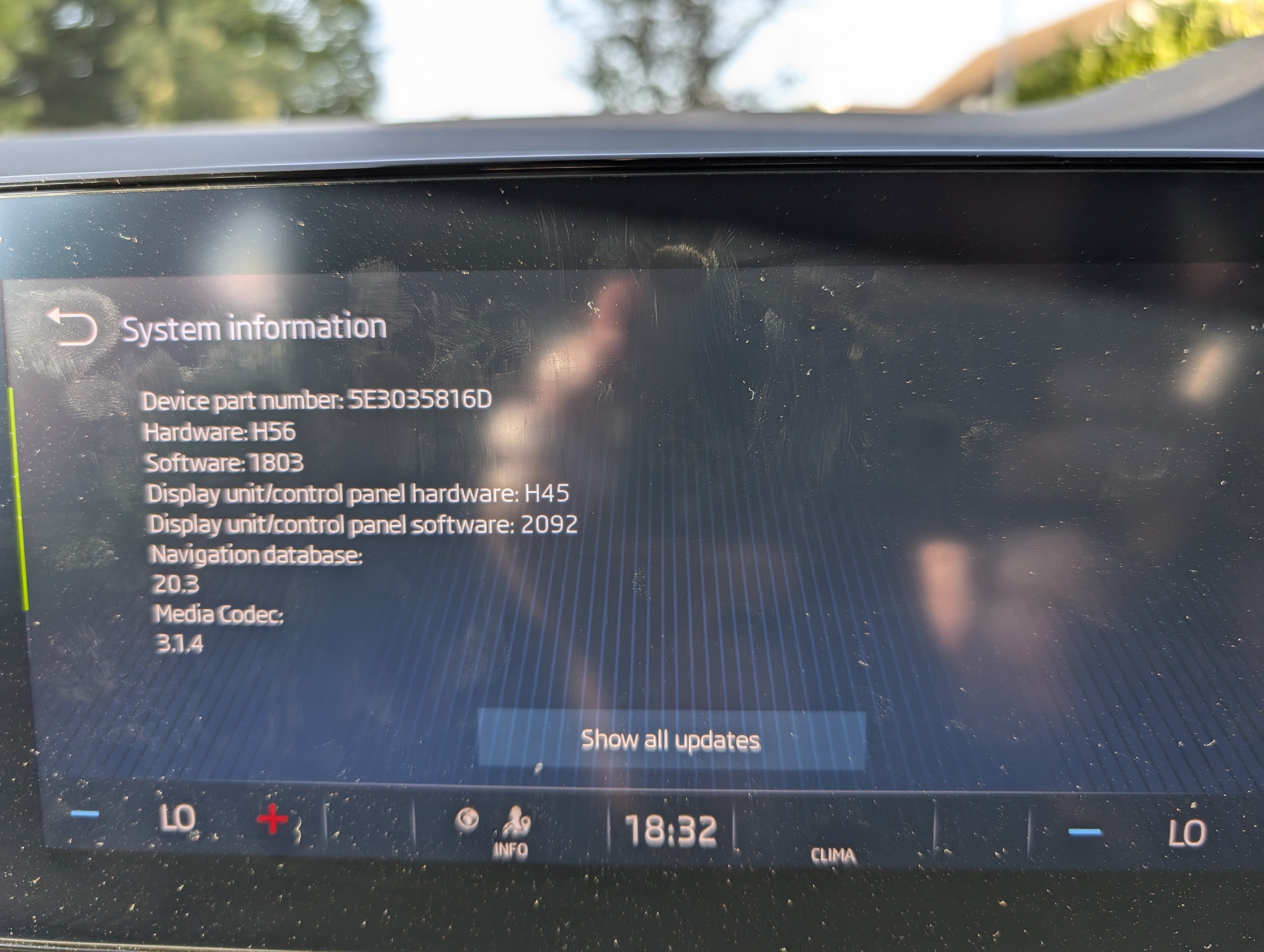

What firmware version of the car head unit do you have?
It did the same with me, I would unplug it, and try to set it up the normal way.... without success. Got frustrated, locked the car up and left it for the day, but the next time I used it, it was working wirelessly.
I've taken a photo of my software set up, 1803...buggy as hell, but Android Auto is working wirelessly...
Great that it worked for you! What mobile device do you have? I tried with 2 devices, my Sony Xperia and my wife's Samsung A33. In both cases I got same result. This is why I suspect that car firmware is an issue
