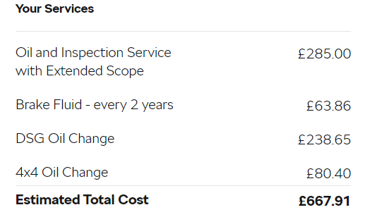

My 2017 280 is warning me of an oil service @ 94k. Also aware it will need DSG & Haldex doing at 100k as it was last done at 60k according to previous owner receipts. My indy quoted £1200 for inspection servicing including oil / dsg / haldex / spark plugs / brake fluid / pollen filter including labour. Have just looked on the Skoda website and can have all this excluding spark plugs for less than £700!
I think the indy is a bit overpriced in comparison!

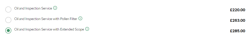

Oil & Inspection service and extended scope.

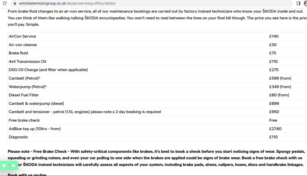

The Blue chart was 2021 prices at participating dealers.
*** That shows as over £700 back then and costs are higher now.***
