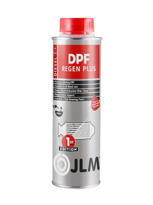

Needing a bit of advice, I’m a new Yeti owner 2.0L TDI Adventure 2013.
I recently put in a Dpf cleaning additive and have noticed white smoke coming from the exhaust, is this normal
Well, at least the snake oil is clearly doing something this time.
The only DPF additive I've used is the Miller's one which lowers the temperature that re-gens kick in, so you don't have to take it for a thrash down the motorway first.
I used this stuff last week . Nearly at the end of the tank diesel this week after a few long drives on the weekends and short week day commute journeys. I have noticed the fans have not come on when parked up after short journeys as it did when i first had the car but that could be  because it had been sitting on the sales forecourt for a bit and not been driven .

My fans came on too once I put my additive in. I took some advice and drove it down the motorway in 4th (3000rpm) and since then no smoke or fans. So I take from that that the additive did its job
No, it'll be the other way round...
I put about a litre of DPF cleaner down the o2 sensor hole, it sits for 15 minutes before the engine needs to idle for another 15 mins.
Smoke is a big grotty and smelly, but differential pressure was down afterwards so it did something.
How can it possibly do that?
The ECU decides when the conditions are correct for it to command a regeneration, oil temperature and DPF temperature are both input parameters, if snake oil were to be able to lower either of these temperatures which I doubt the regen would not be commanded.
